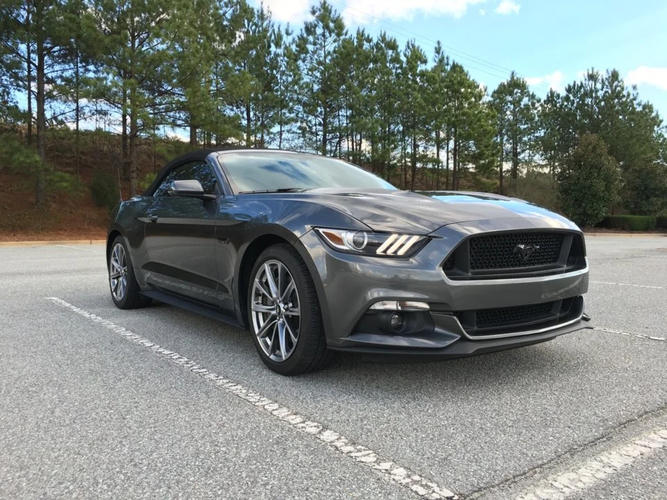

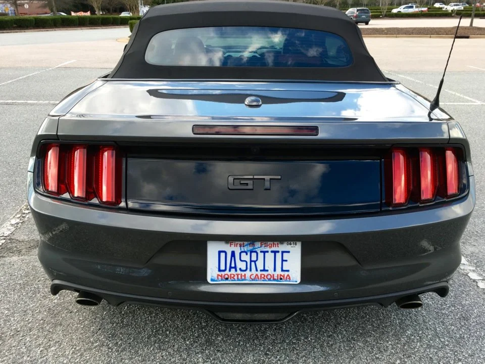

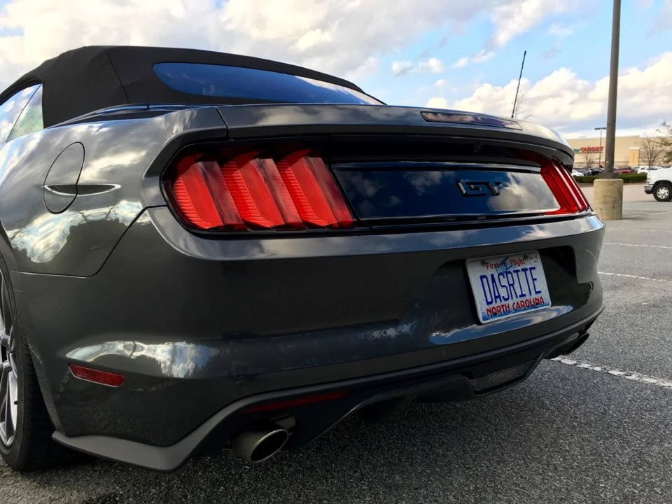

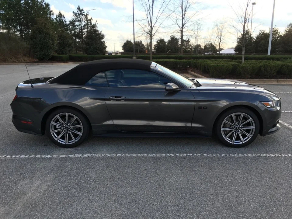

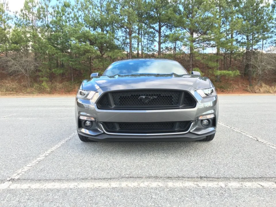

No problem. Turns out the rear one isn't available stand-alone. Have to get the whole deck lid if you want that one. I've got a full set of black ones on mine now, but wanted to switch them all out for OEM. Oh well, I'll put on these three when I get them then decide what to do about the rear.
My black Ford Performance Package wheels/tires will be here tomorrow to finish off the look.

Looks awesome! Did you have to take the front bumper off to replace the horse?
I'm not the OP but no, you don't have to take the bumper off. You just reach behind and break the tabs off that are holding it on. This does require removing a few plastic pieces such as the radiator cover. Make sure to get a new set of retaining rings because the old ones won't work. Those are W708203-S437M.

So how did you do the rear emblem?
