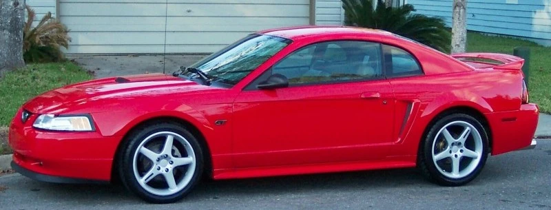

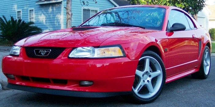

I've had my Bullitt shocks/struts C-spring combo on for about 3 years now....no complaints whatsoever. Best $350 I ever spent. :flag:
Here's a recent pic. I just switched from 275/40 up front to 265/35 because it rubbed when fully turned, so there is slightly more gap than before.
Looks good, but I think the C springs dont drop the car enough. But as far as the price goes for the C springs, you cannot really beat that.
Try some Steeda Sport Springs :nice:
Don't drop enough?
Mine have settled more then I thought. I installed mine 2 years ago and they dropped at least 1 3/4 to 2 inches in the front and 1 1/2 to 1 3/4 in the back. Much lower and I would be able to drive on city streets.
