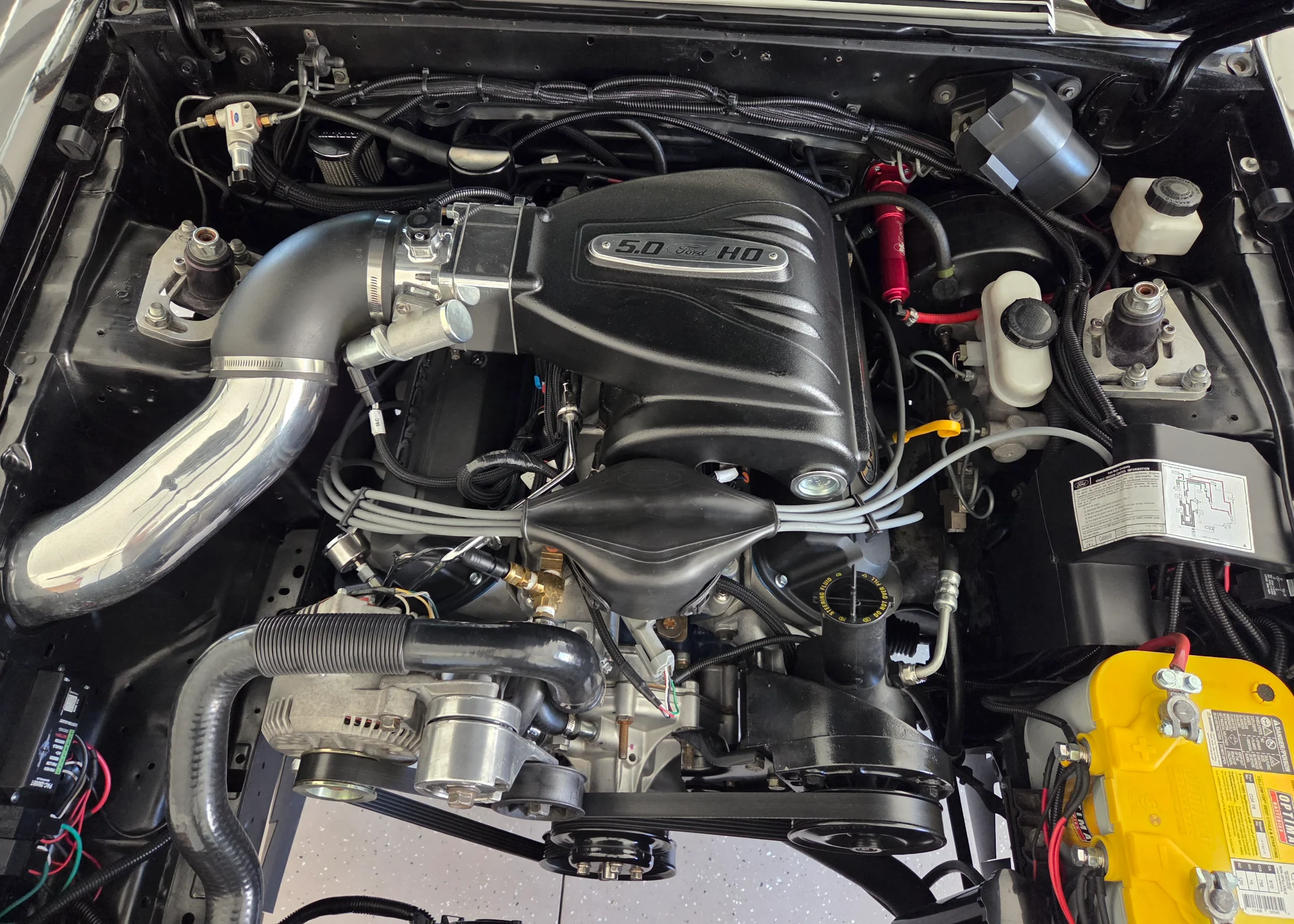

Hello, new member here. Sorry to jump in your thread @Habu135, but maybe what I get done can help you as well. Was reading through this thread because I am looking to changing out some things on my car. It currently has a Holley Sniper 2 and I am going terminator X. I am trying to figure out what intake I can fit on my Ford Z2363. The valve covers are tall so I am guessing these are the ones to go with from reading this thread? How much more clearance do they offer?
BLACK SATIN VALVE COVERS
BLACK SATIN VALVE COVERS|Ford Racing Parts
performanceparts.ford.com
I am not crazy about the looks of the Holley Systemax style, I would rather have a Holley Hi-ram side mount type. If that is wrong or wouldn't work please let me know. I am going to get a 2.5" cowl hood installed as well.
I currently have a Trickflow R Series intake on it. However, many have told me I'm leaving horsepower on the table and have since purchased, but not installed, a Trickflow Box R intake.
I'm currently running a Terminator X and am happy with it. I went back and forth about different valve covers, but am happy with the flat black non descript ones which came on the engine from Ford.
I have a stock height fiberglass hood with no underside cross bracing. I wanted to maintain the OEM look and the no underside cross bracing frees up some height. While the Box R is approximately one inch taller than the R-Series, I'm currently running a spacer and suspect the height will be nearly the same without the spacer on the Box R. If the Box R does rub the underside of the hood, I plan to have it machined down a bit.
Good luck and check out my progress thread below. It has a lot more info.
Oh so you left the valve covers alone and put a spacer in and the Trickflow R fit? Good to know.
Does some of the OEM hoods come with no cross bracing? I know my 96 to 98 Cobra Hood has cross bracing...
I believe they all have hood insulation and cross bracing. My hood has neither.

from6to8 said:
Have you seen anyone put a supercharger on that crate engine?
No. Turbocharged are currently popular. Neomustangs has a turbocharged 363. And I believe War Admiral is a turbocharged 363. My car should make around 420 once I install the new intake and add some more timing. It's a handful now through third gear with 400 rwhp.
View: https://youtu.be/Vs0Gr617p5Y?si=pLjWGg_sS8i_bHUT
