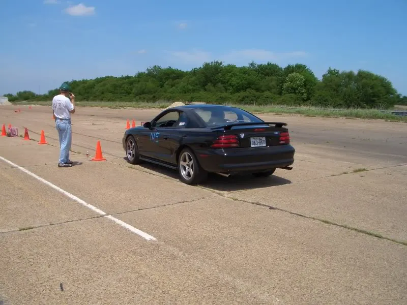

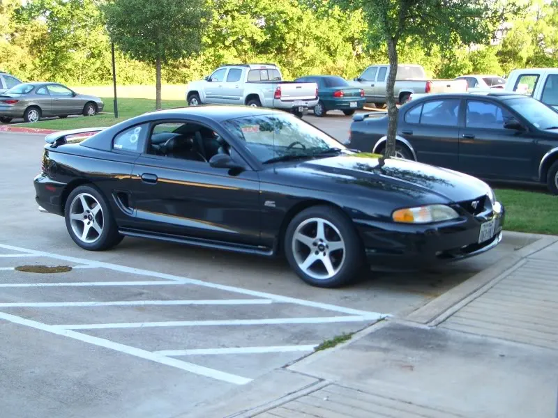

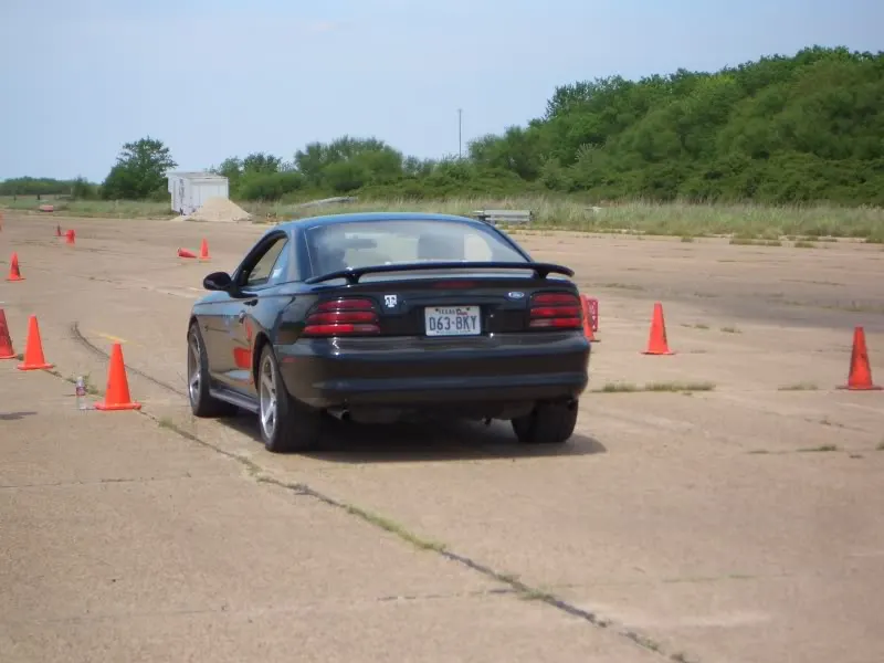

The widest wheels Ford offered were the 17x9 1995 Cobra R, 18x9 2000 Cobra R, and the 17x9 2003-2004 Cobra's. Just search through here and look for pics, plenty of people have them. But if you don't want to search...here's one of 04 Cobra's with 275/40s on my '95 GT.
