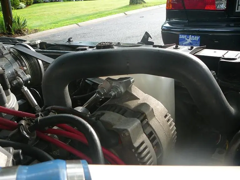

at the top of the alt, the tab that attaches the alt to the march adjusting bolt is upside down because it did not fit right side up. it is supposed to be situated such that the curved part of the tab follows the curve of the alternator

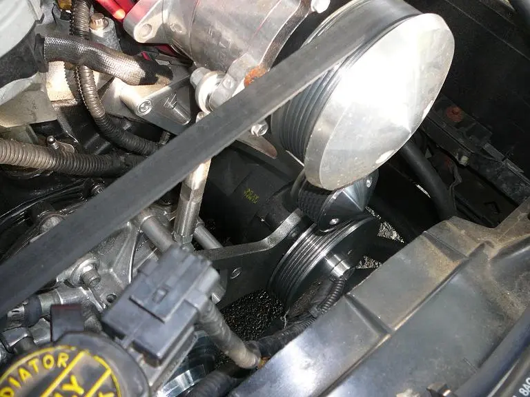

here is a pic of the new location of the power steering pump. the march set i got swaps the a/c and the p/s; the a/c is now on top and the p/s is below it. i do not know if a sn95 power steering pump will fit there or not

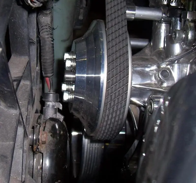

yeah, there is not much clearance left with the fox water pump. that said, it does fit and i have not had any issues. then again, my k-member allows for a inch set back, but i don't remember if i have my engine set back or not, but i do not think it is set back.
here is a pic of how much clearance i have:
bottom line: it fits, but it is tight
