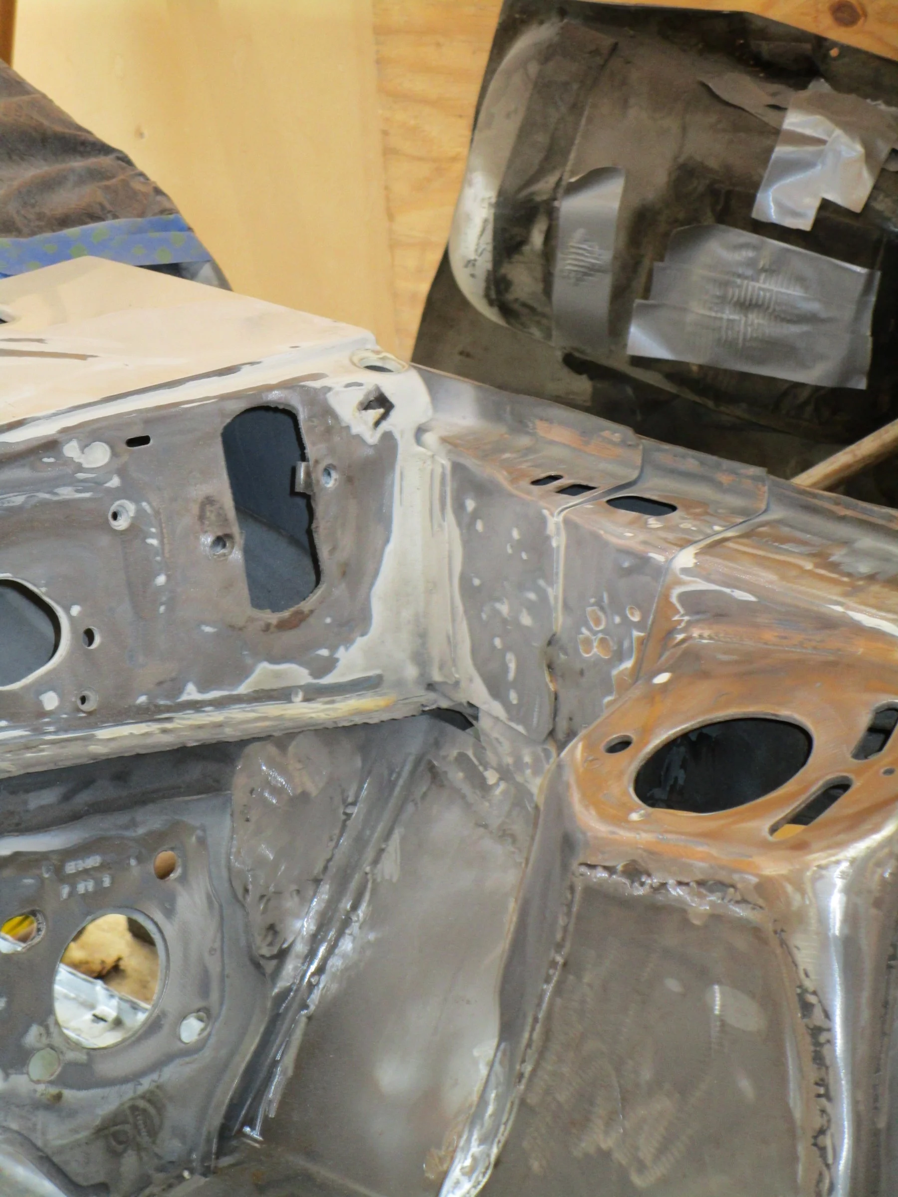

This is one of those clustereff areas, right around where the booster sits. I can still get in there a bit more with the 2" grinder, but all those lap joints are being problem areas. Theres also a bunch of tight sports around the headlight area that I tried to take a quick pic of, but failed (way too blurry and I'm too lazy/tired to try again right now).

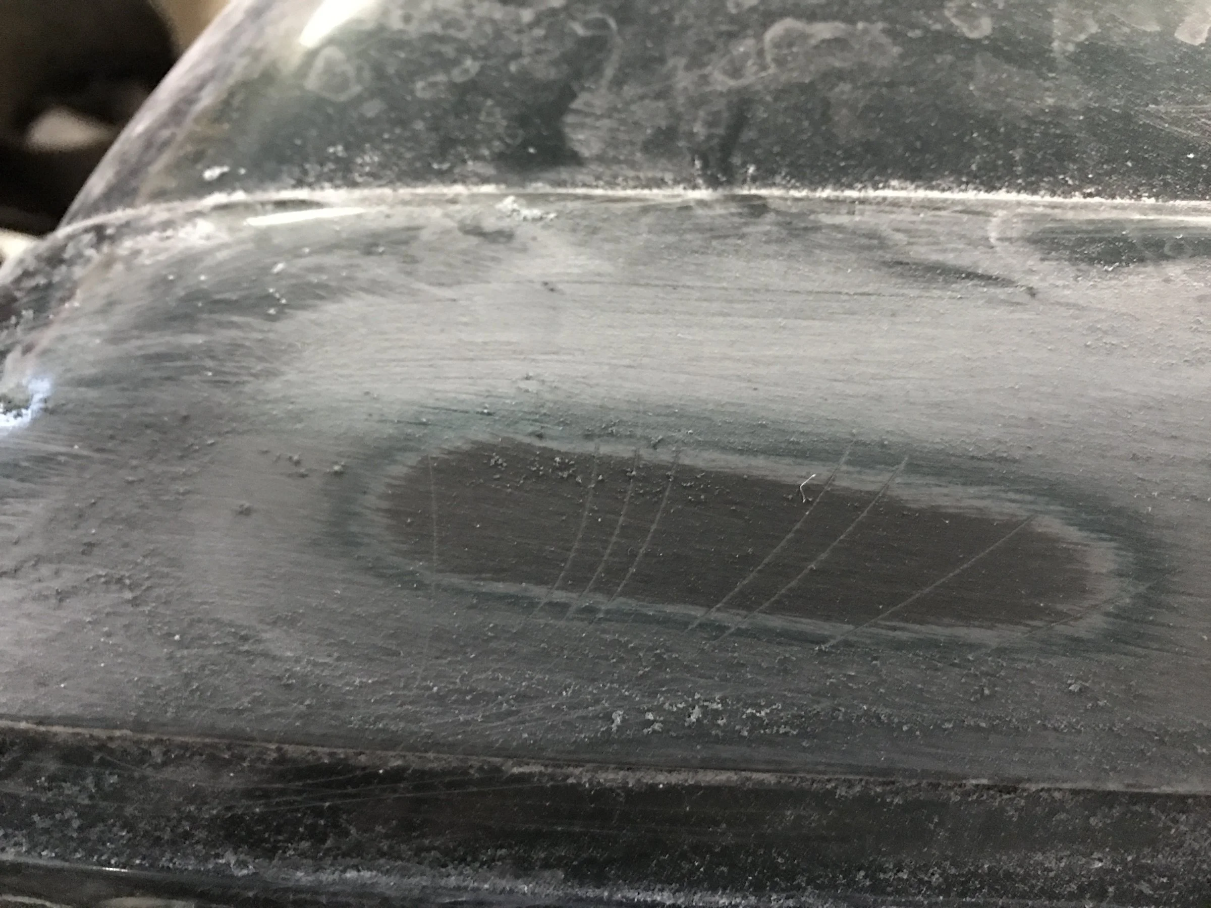

So the new rear bumper has a few cracks like it Had been bumped a few times. I sanded it down but it looked like the cracks are pretty deep. They don't go all the way through the bumper. What can I use to fill the cracks in? Do I need to go down to the plastic and into the bumper to get rid of them?
Yes and maybe. Get rid of all the paint in the area, it's screwed.
Once you've done this, post a picture of the plastic.
If the plastic opens up in those cracks when you flex it, then they need to be repaired. Depending on how bad they are, I'll give you some advice for that repair.

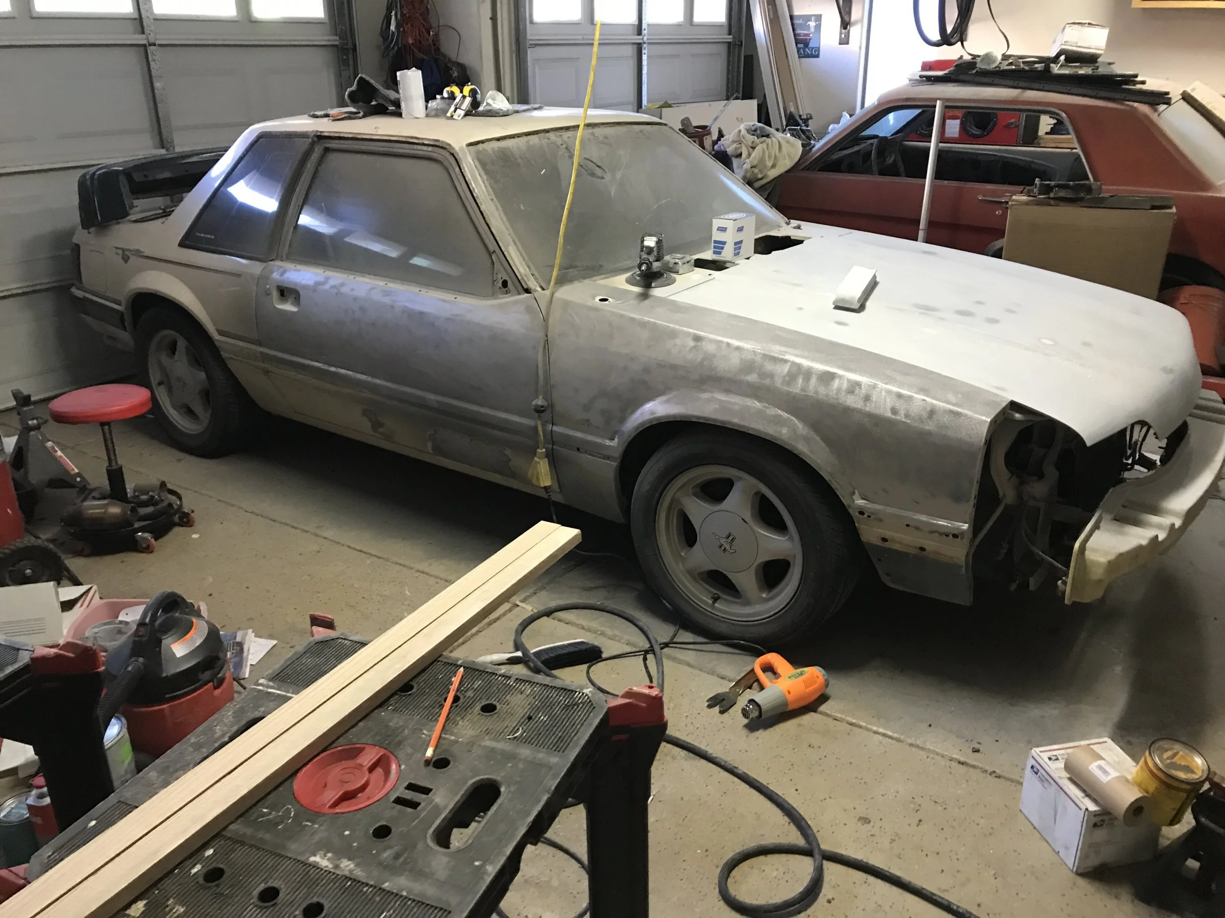

Current progress. Stripping down to metal is very tedious. Even then, some of the primer or sealer is still present here and there.
Here is the rear bumper a rear I was talking about. These cracks are through the clear and paint and into the sealer or primer it look like. I handed sanded the area so I could go slowly. I may take the DA to it now because it is taking too long.
The plan is the door jambs, trunk jamb and hood jamb will just get a light scuff and then rest of the car will get primered before shooting it all with bc/cc. I've gone to a 40 grit to strip it, being careful not to heat up the metal. I will go back over it with 180 to smooth out the metal and rough edges before primer.

So you have minor cracking of the plastic. Here's what you'll want to do. Fold some heavier grit sand paper (36-80) and sand a shallow V into each crack and fill with a plastic repair kit. You don't have to use panel bonding adhesive (though that would be a great fix). Remove the paint completely from any of the cracks.
You can use almost any flexible plastic repair to seal those up. Not bondo, that will harden enough to crack. Then just treat it like any repaired area with primer, blocking and refinishing.

Sounds good. The crappy part is you are only seeing a part of the cracks. They are more like spider cracks. That was just the area I sanded off. So, I got some work in front of me.

Mainly worry about the larger cracks like you see in the photo. You'll probably see stretch marks too that look like cracks. They don't have to be addressed like the cracks.

I got a lot of the bad spots down to metal and just when I think I can scuff the rest of the body that paint in that area just flakes off like nothing. Looks like the sun really did a number on this thing. Going to take it down to metal on main body and scuff the jambs. A lot of work to get it down.
