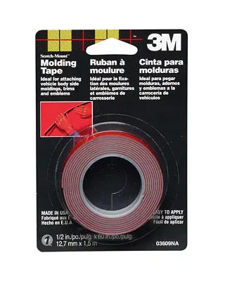

Calling Dave @Davedacarpainter
The door molding is coming off the car again for the 3rd time in 15 years. I have taken the metal backing off the molding a few years ago, so the molding lays flat.
My question is: Is there something better to use then just the standard 3M double sided tape. I want this to be put on and never have to worry about it again.

The 3M tape will work fine, just get an adhesion promoter wipe from 3M and wipe the mouldings and the door before you stick it down. This seems to work really nice.
Thank you Dave
I didn't use Adhesion promoter, so I will this next time

stanglx2002 said:
Thank you Dave
I did use Adhesion promoter, so I will this next time
...and use the red-backed automotive tape instead of:
That is what I used, and is currently starting to peel away from the door
Do you want a picture of the adhesion wipe’s package? I can go snag one from one of the bodymen.
Sorry Dave, I meant didn't use the promoter. Can I just use any from an auto parts store
Sure, it’s just these little packets with a wipe would be cheaper for you is all.
