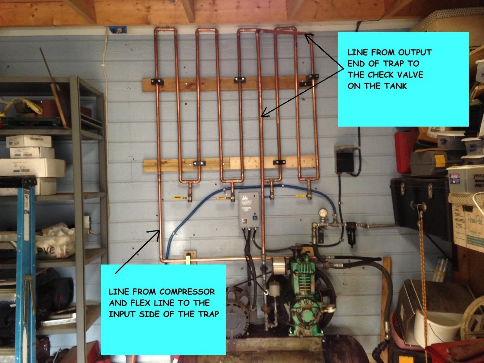

That will only help for a short period of time John.
You will want a water trap system of some sort.
Finding a filtration system that has desiccant beads to remove the water is extremely helpful. I have no idea of the cost of a large system, but you can get small disposable ones that attach to your paint gun fairly cheap.
Reactions: 02 281 GT
From my understanding, for any kinda water filter to actually work right, you have to cool the air down. There are several at home options, some built copper water traps, some will use an old house ac A coil between the pump or tank, and there is a home made cooler thing that I forget the name of. A simple thing just to get you buy is to run an extra air hose before your filter and coil it up in a bucket of ice water, then the filter .
