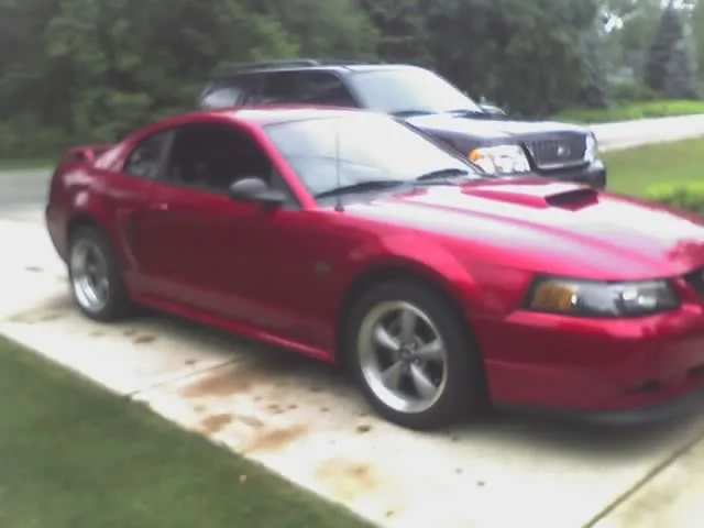

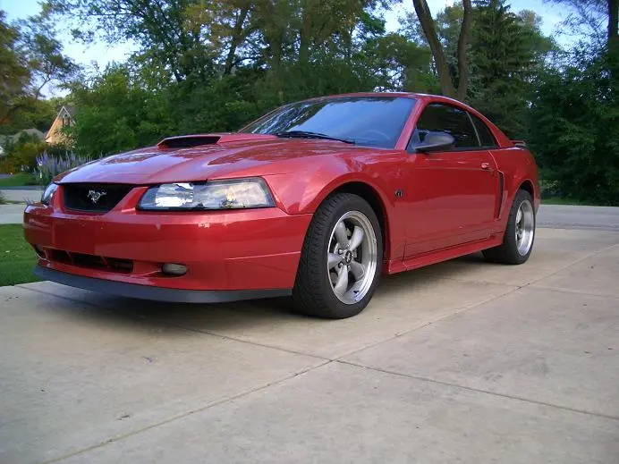

I got my fox body springs in this weekend. 4cyl springs in front and V8 springs in rear cut 1/4 coil. drop was about 1.5 inches in front and 1 inch in back. took it out to test handling....around turns its the same as stock, felt identical to stock all the way up to about 110, i didnt want to go any faster. When I launch the front end comes up a LOT more than stock, also when I downshift into second geara and go full throttle the front end flys right up. Only complaint would be slightly more nose dive when braking hard. They should settle a little, theyve only been on less than one day. Heres pics...
First pic is before...second is after...sorry for poor quality pic was taken with my phone, i will post better pics later.

Nice Ryan. :nice: Finally someone who doesn't slam it down into the weeds.
RE: Weight transfer - I guess that's the tradeoff you get - if you want the weight transfer for takeoffs, you're also gonna get it when braking as well. Maybe some better struts would help this? :shrug:
