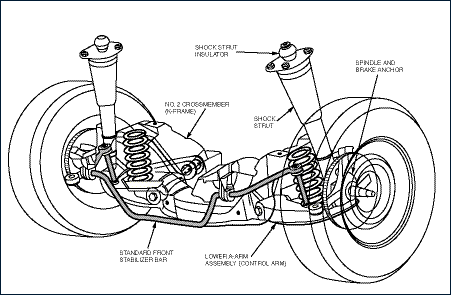

In general, the good news is that the strut tower on a Fox does not actually carry the weight of the vehicle because it uses a "modified MacPherson strut" front end setup wherein the weight of the car sits on the lower (only) control arm via the coil spring. All the strut tower here has to do is withstand the pressures of the strut itself pushing and pulling on it (the strut is a shock that also serves as a structural part of the front end architecture).
Most cars today have strut towers that actually have to not only handle the strut pressures, but more significantly the actual weight of the car (with the coil springs located up inside the towers).

The strut tower plays a huge role. The top of the spring does not extend into the upper part of the strut tower it has it's own mounting pocket in the crossmember (k-frame). If you look at how the k-frame is mounted and the function of the strut tower in relation to the chassis alot of rust in this area can be a huge problem. Like stated before this can mild to wild has far as rust damage goes.

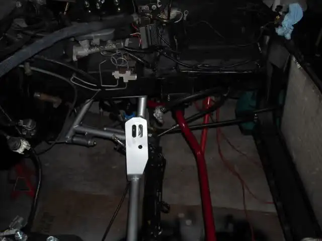

I just had a friend fix mine..it was totally rotted out on the drivers side..he had a donor piece he used...it can be done if u want it to be ....just can get pricey if its bad..depending if its really bad the engine and sometimes the whole k member has to come off to do it right...heres a couple pics of mine
from this
to this
