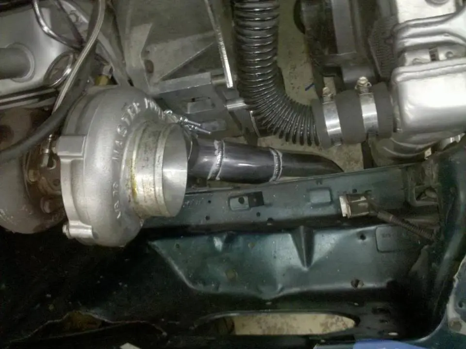

Now it's getting:

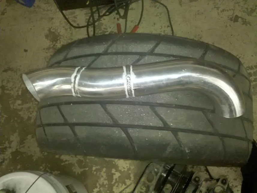

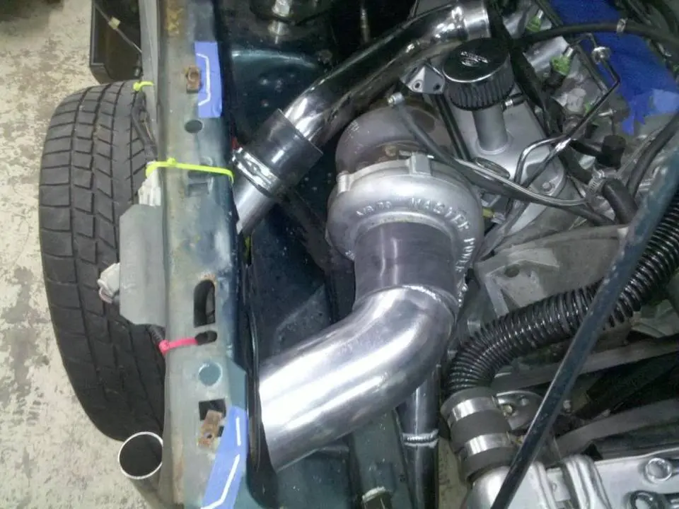

Modified intercooler piping(Hellions original design SUCKED!)

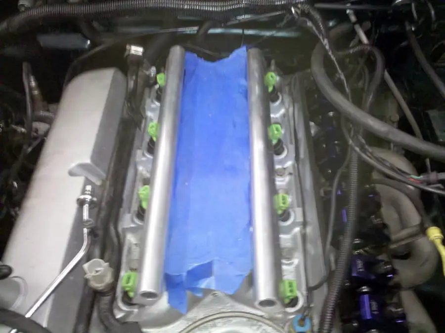

Custom fuel rails and lines

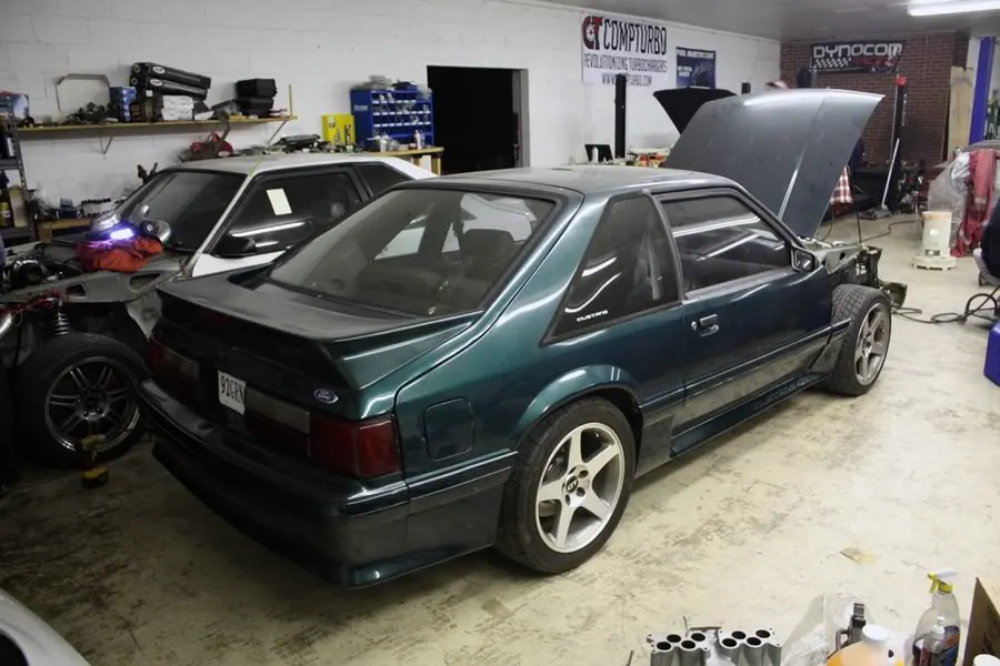

Pics:
What it'll look like when done(Photoshop) :

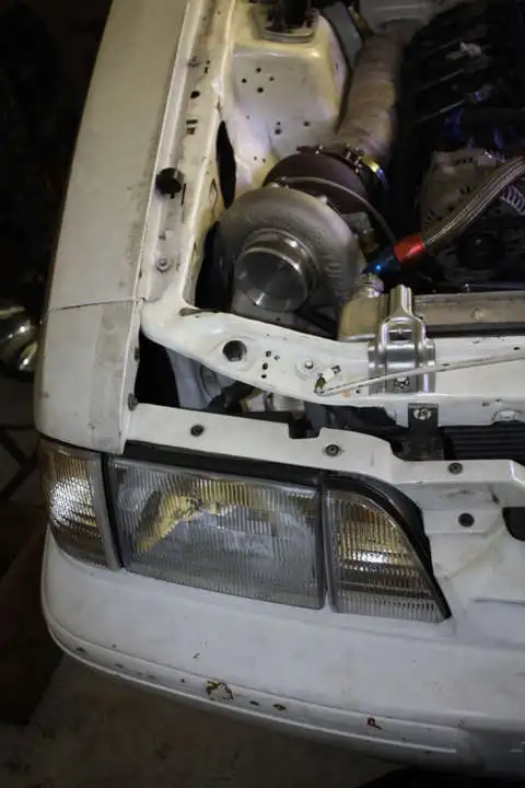

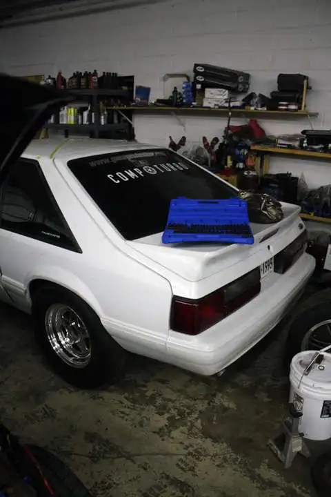

Everything is so nasty from where it's been sitting :(

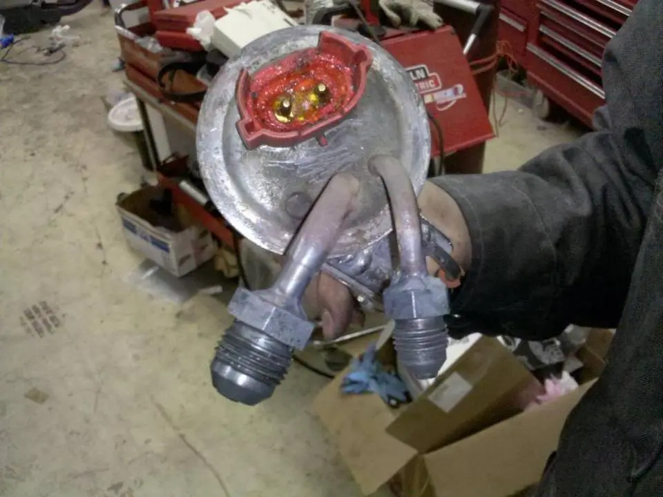

Modified factory pickup:
Be running two -8 lines directly to the rails, -6 to the reg and then a -6 return.
Single pump for now and then when the "good" engine goes in later it'll be upped to a 3 pump setup. The catalytic converter came in yesterday, looks pretty good.
