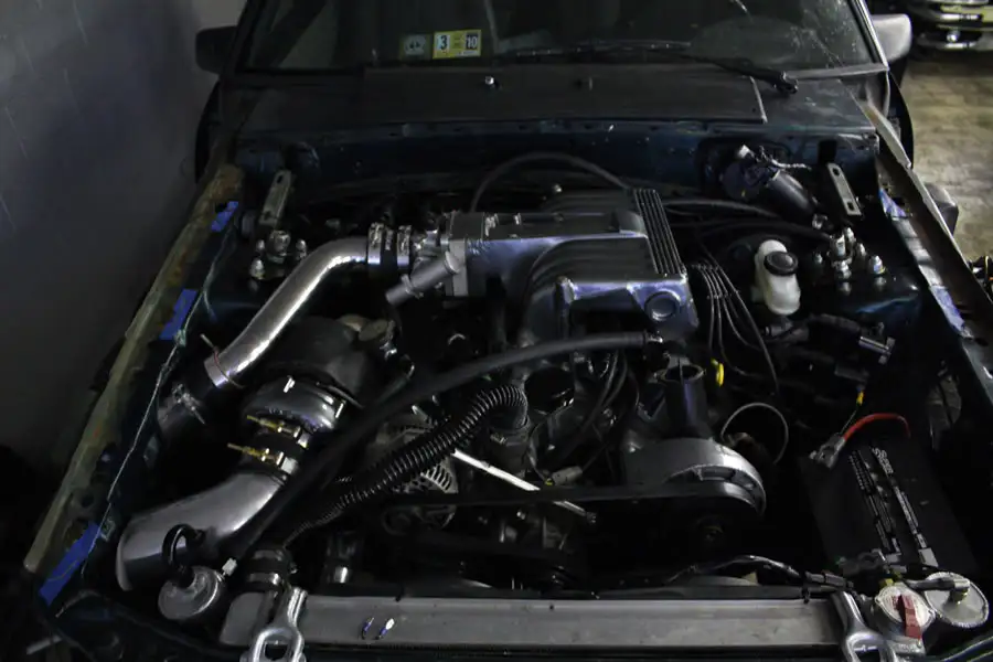

Installed the Ford Racing A/C Delete and the March alt bracket. Really cleaned everything up under the hood. Might go ahead and install my battery relocation to help clean things up under the hood for now but everything else is finished. Just lack doing the part throttle/start up on the tuning, should have the car back home this week, can't wait to start driving it!

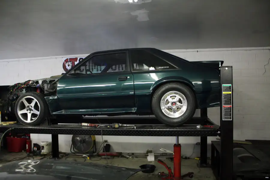

Man, test fit these and while they don't fit good I guess with a few modifications they COULD fit:
Car is still on the jack in the pic, so it wouldn't have THAT bad of a rake to it.
Underhood pic, dark as hell but I didn't have much to work with(like normal) my lens sucks for this type of stuff:
