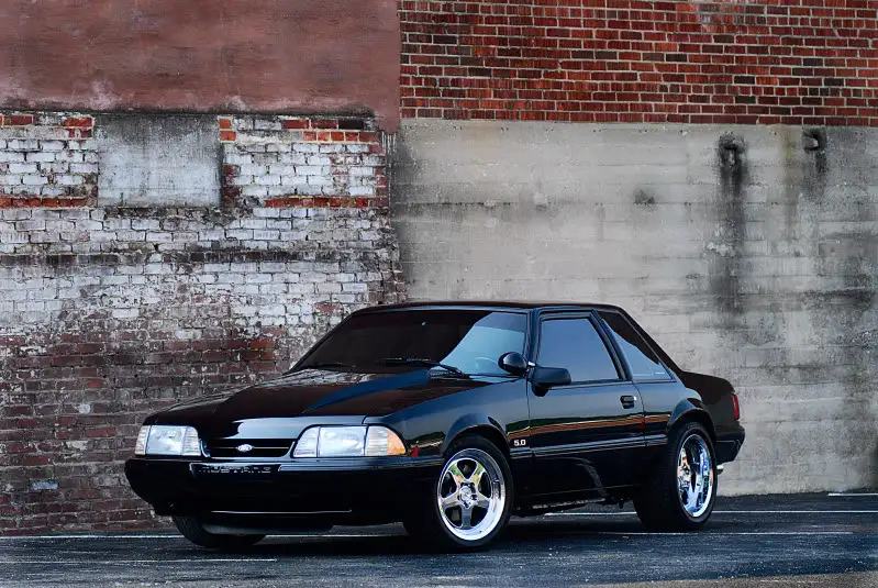

Here's my car, 17x9 and 17x10, 255/40/17 on front and 285/40/17 on the rear, I have 94 model spindles and stock track width out back, had to roll the rear fender openings

wow that car is amazing had to log on to tell ya!
Thanks, years of sweat, busted knuckles, mod after mod, change this, change that and it's finally done. If only I can get my 86 coupe looking as good I will be thrilled!
MOARRRRRRRRR PICS!!!!! That car is hot!!

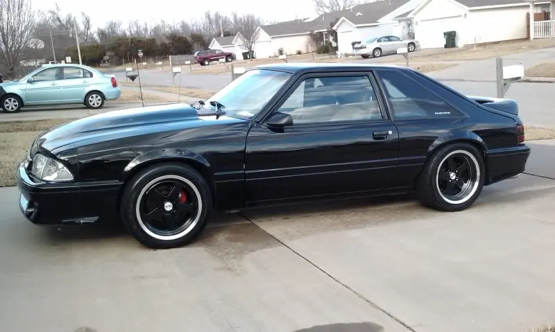

245/45/17's on 17x9's up front...had to install rack limiters to prevent rubbing at full-lock.
275/40/17's on 17x10's out back...had to remove quad shocks and that's it. i rolled the lips too, but it wasn't required.
