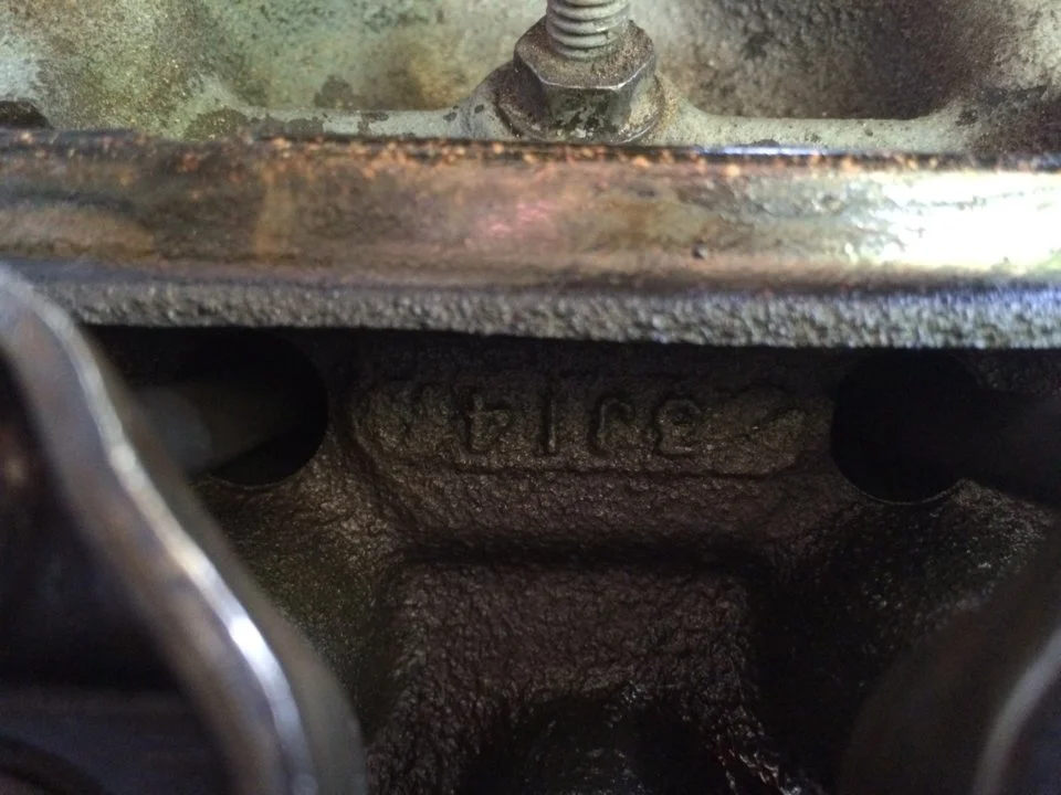

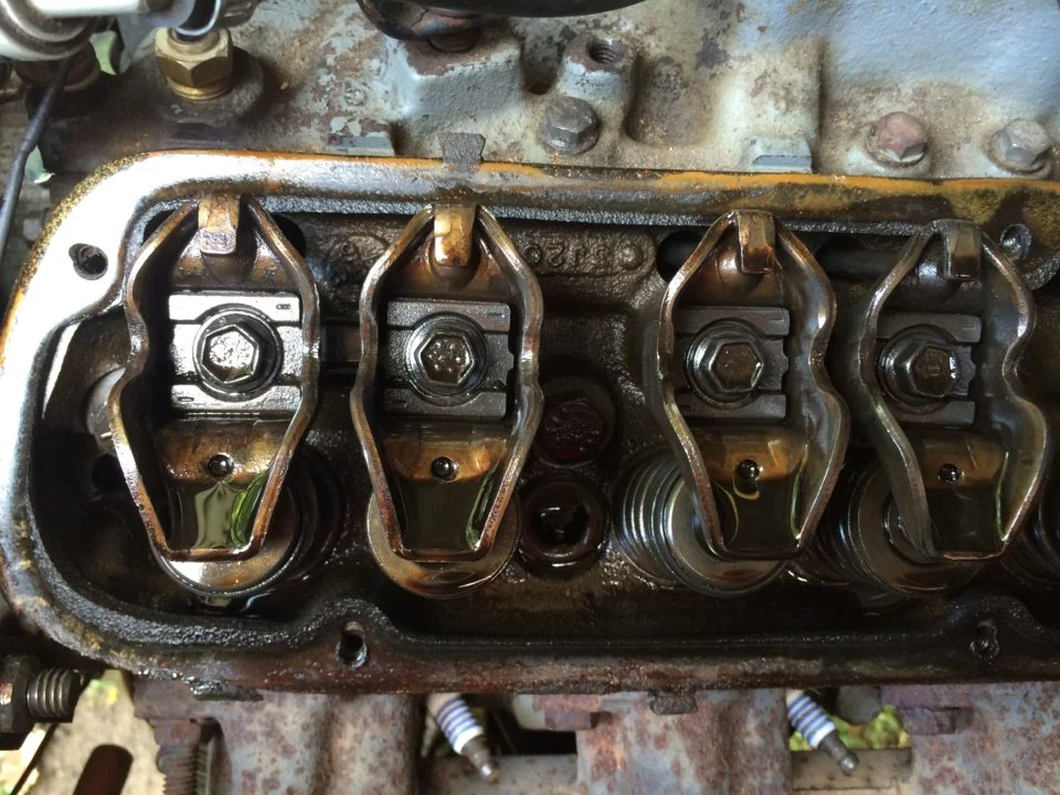

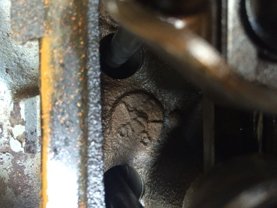

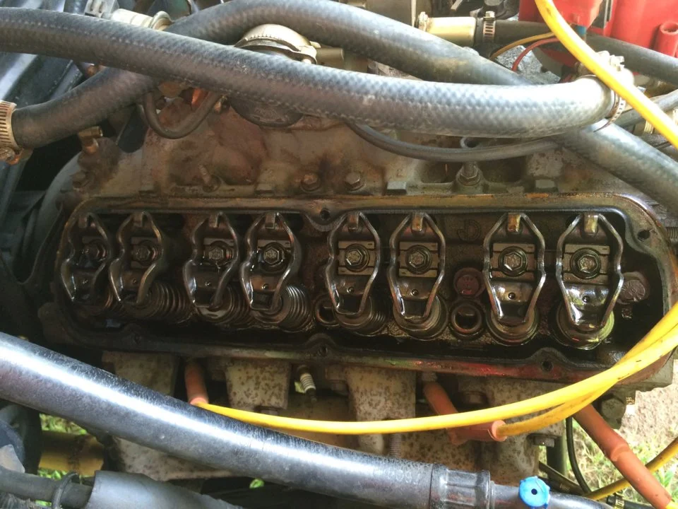

Thank you for the info and speedy reply. Are E5 blocks worth their weight? As far as pictures go, I've got them. Under the valve cover on passenger side I believe it reads 3J14. Drivers side reads 3J20 and 8&5

Unfortunately the numbers that would be most helpful are underneath the head on the bottom side where the pushrods pass. The heads will either be E5. E6 or E7
However, one pic looks like a casting date stamp pointing to a 7. So 1987? Can't make it out too well
