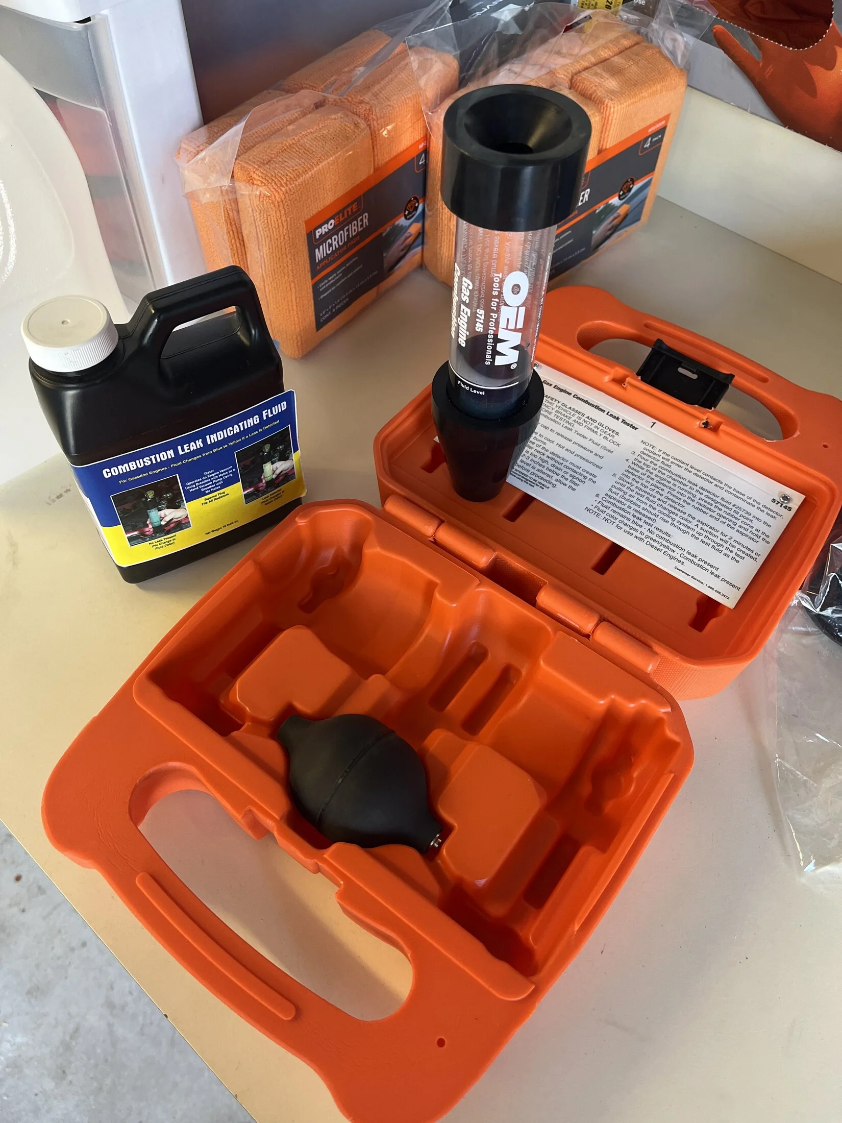

Just tested it using a renter from the autostore. Fluid stayed blue and never changed color, so no head gasket leak?
It’s one of the hand pump ones where you squeeze a tiny vacuum ball so maybe it’s just a crappy tester?

Noobz347 said:
You're not talking about his thing, I hope:
No haha. Mine has the same ball tho. I’ll snap a pic
Combustion Leak Tester. That's the one!
