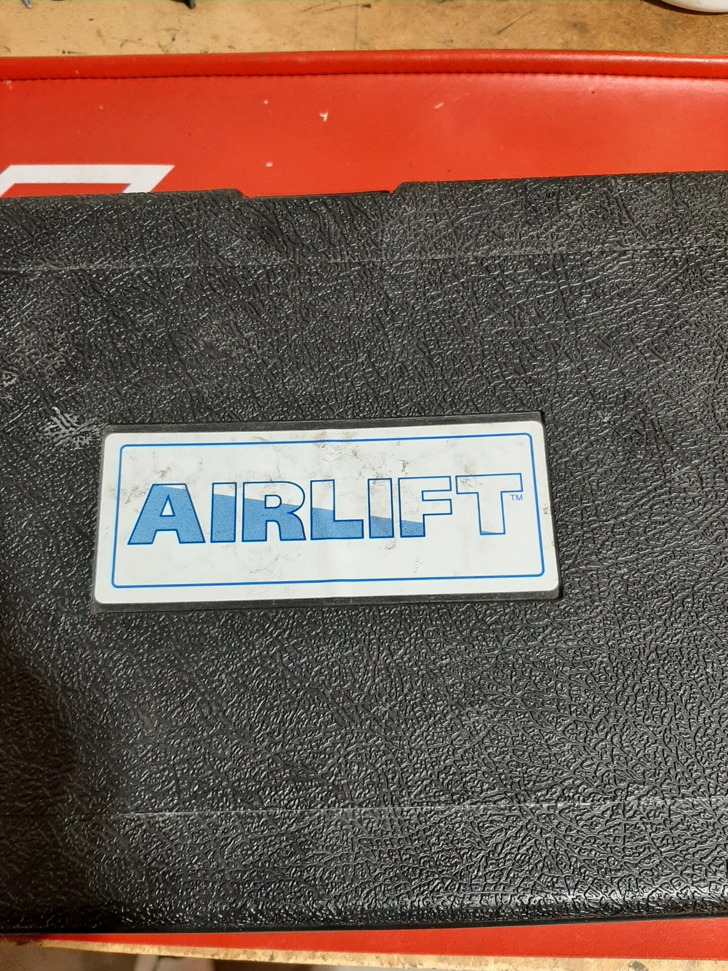

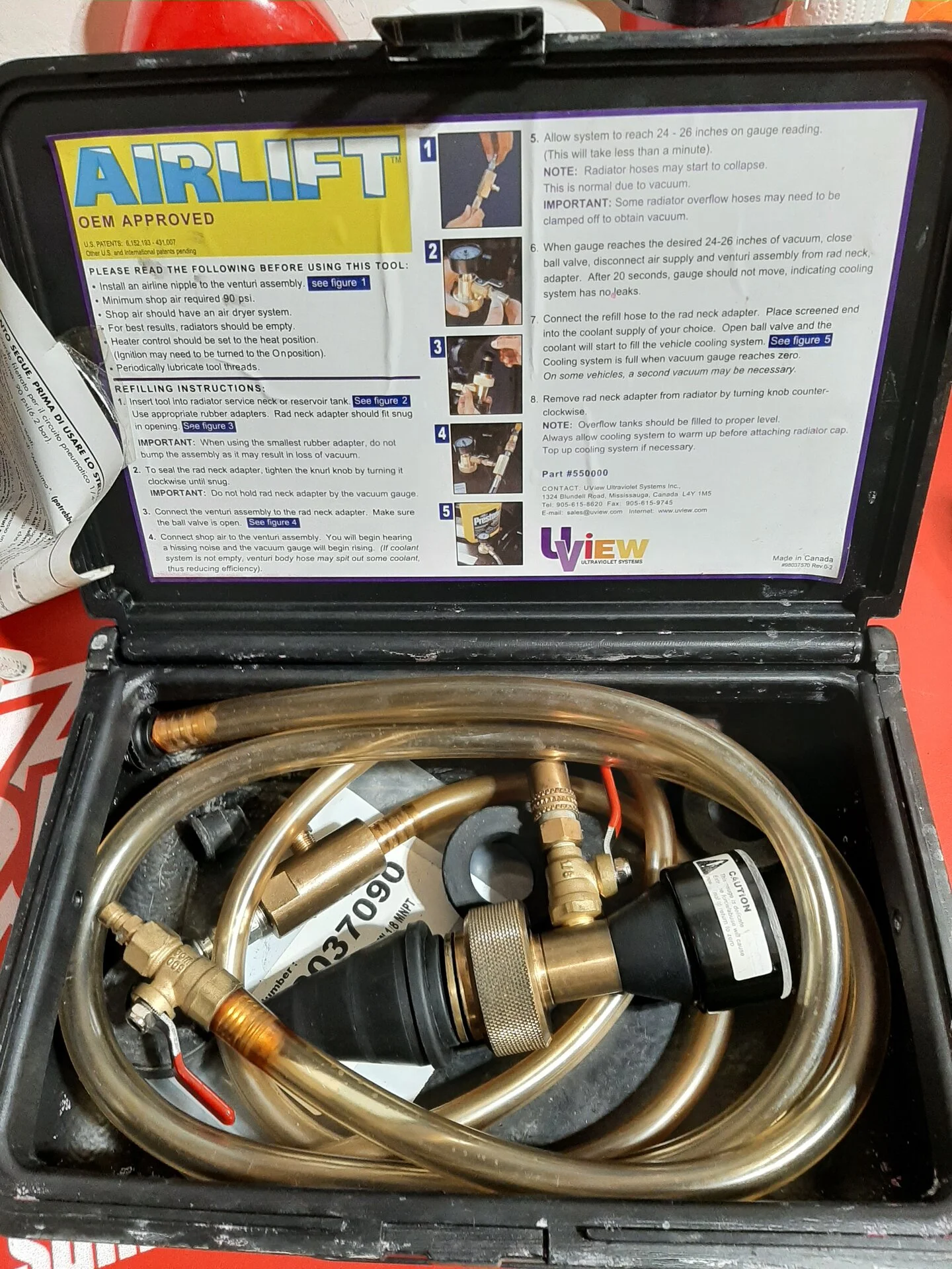

We use Airlift coolant fill systems every day. My car had a brand new 3 row radiator but the lower hose would collapse and cause a flow issue. This is stated from experience, not a theory.

You mean like this:

You mean like this:
Yup just like that. You should know better than accept that guy explanation. I get caught up in a quick search sometimes, too. The reason is because of hose collapse while the engine is running - not under vacuum during a fill. With vacuum fill all of the hoses collapse and refill with coolant. Most of the older cars had springs in the lower hoses because the rubber would get soft when hot coolant went through them. That softness and the suction from the water pump made the spring necessary.

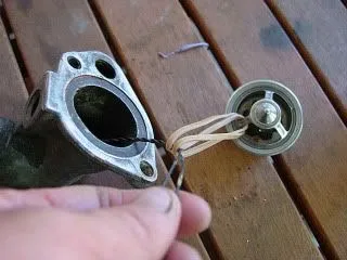

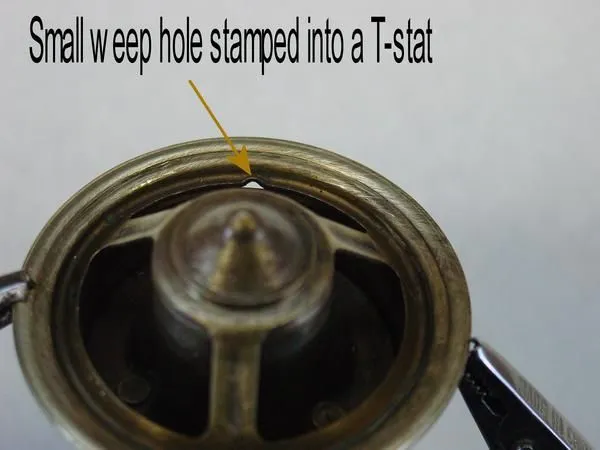

Filling a SBF with coolant is not hard. Drill a 1/8" hole in the perimeter of the thermostat so the air can escape the engine back into the radiator. Would look like this:

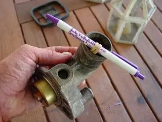

To hold the hole at the top of the thermostat housing you can use a rubber band and pencil / pen / round rod like this:

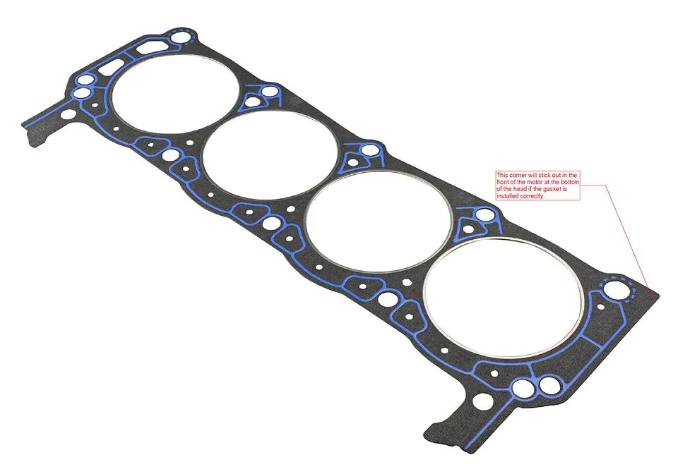

The other thing I read was your concern with having the head gaskets oriented the correct way. It is my understanding that with a Fel-Pro gasket (it is like this on both my SBF's) you will see the corner of the gasket at the front of the motor. It will be sticking out at the bottom corner of each cylinder head.
Confirm this first so we know you got them on the correct way.

More and more I'm beginning to think I installed the head gaskets backwards....ugh
I'm going to check for the gasket sticking out this weekend.
