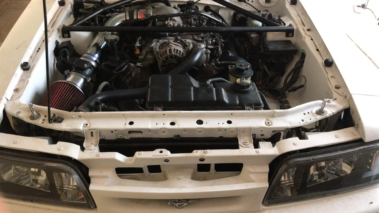

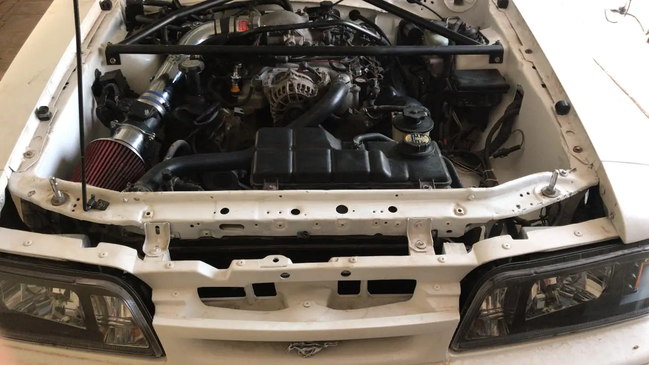

Don’t know if this helps but I swapped about 3 years ago a 4.6L 2V from a new edge in my 90. I used the new edge’s k member. Everything bolted up like stock, just had to open up two of the holes that go underneath the firewall.
