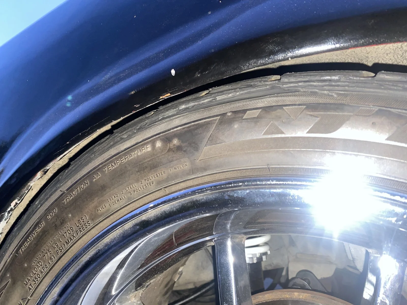

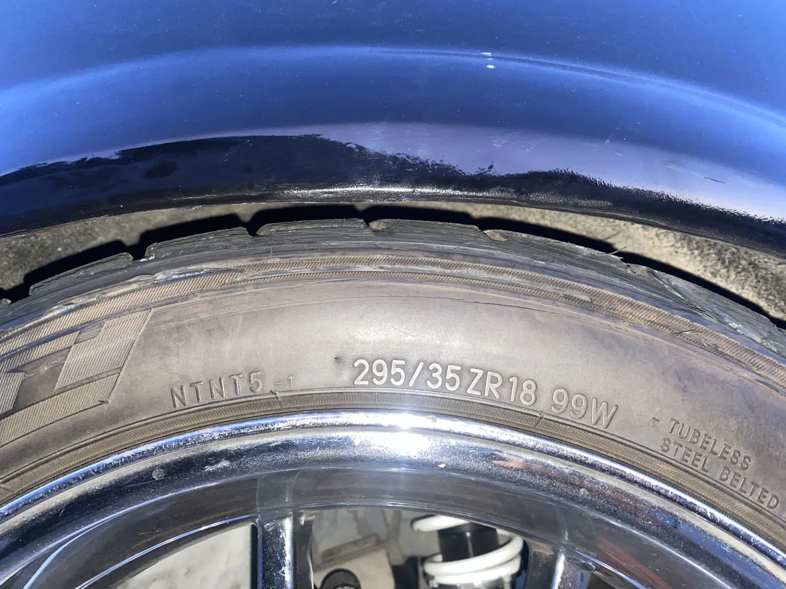

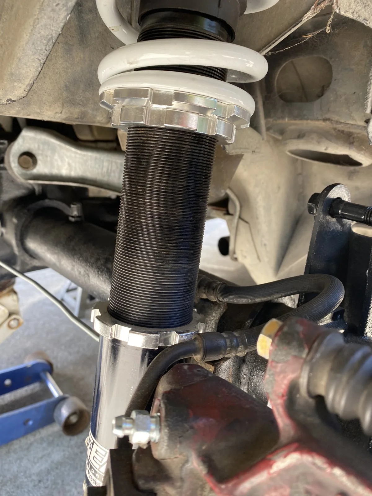

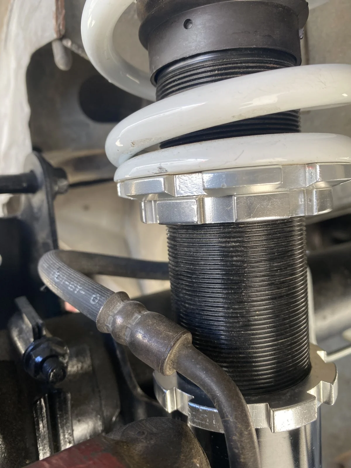

this is what i have to do to get them even. the passenger side rear is raised almost to max and sits just as low as the other side..

Passenger Rear & Driver Rear. Driver does not rub. Passenger rubs.
