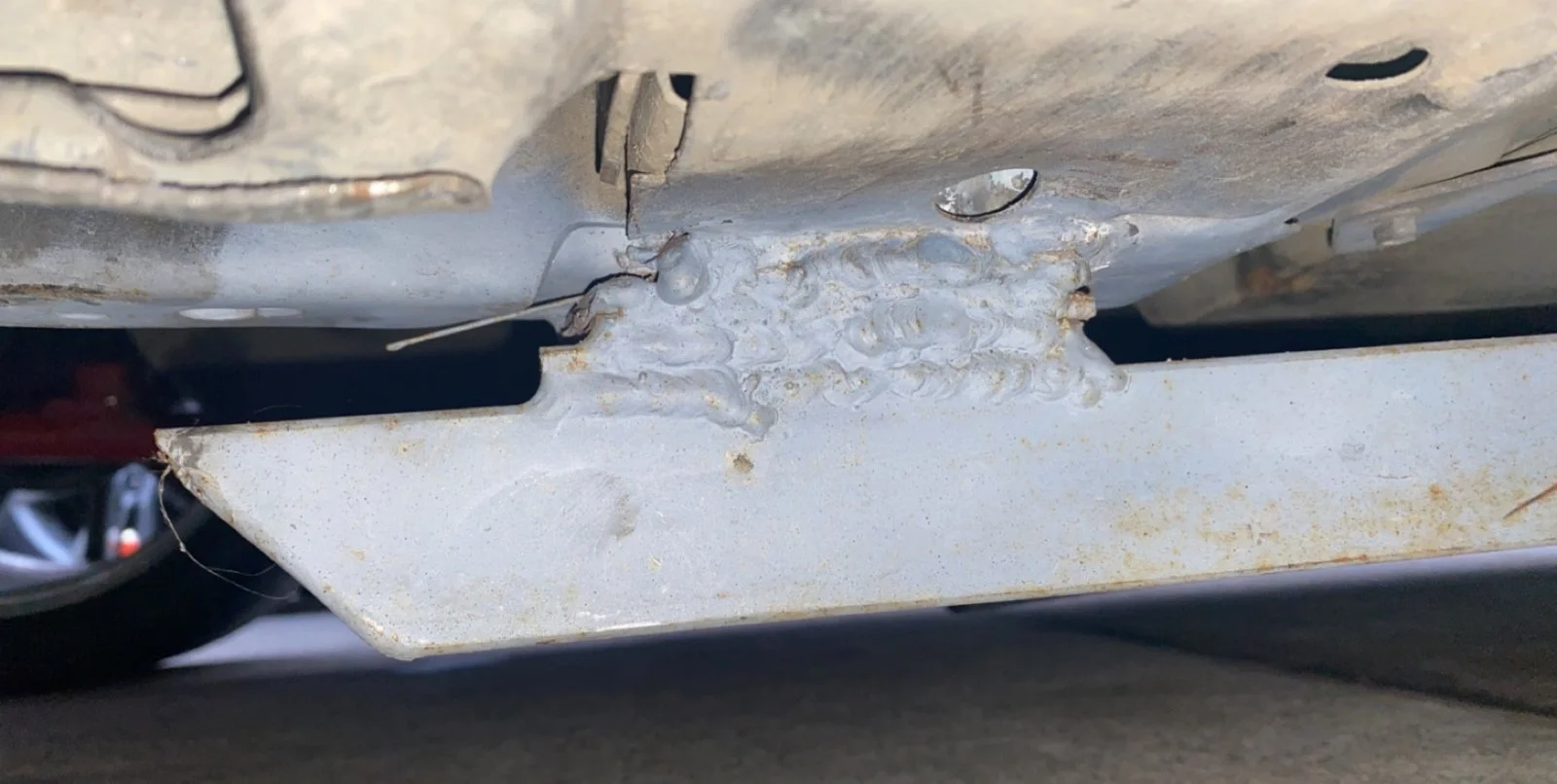

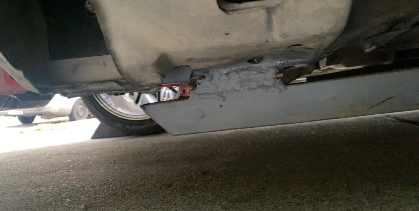

Yeah I thought about cutting them out since i'm 95% they werent installed properly i'll have to cut them out this up coming weekend and see if anything changes. heres a picture of the plates that were added. And I could try doing it in front of my tmrw morning possibly real fast.
pic is the passenger side subframe
connecter.

So that is the passenger rear mount. That is horrible (sorry). I would want to cut it and redo just because of how it fits. Not trying to be a critic or pain but ... UGH
How are the other mounting points?
I fabbed my own SF connectors and welded them in myself and my welds are by no means great either. You deserve a better install than that.

the others are normal but not really sure on how they were installed. i'll cut them out this weekend.
damn those welds are terrifying.. do like you said and cut those sfc off then put that car on a frame machine. Once you know it's straight again then you can have subframe connectors welded in the right way.

Like stated. Get that car on a frame machine at a body shop. They can straighten it out. They usually have a good welder or 2 that can weld the subframe connectors back in right, too.
Reactions: General karthief
just an update I did remove the subframe connecters yesterday which actually was not as hard to take off as I thought. no change in height though. Guess i'll take it to get measured. Don't know why this randomly happened. unless there is something I installed wrong?
