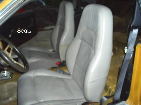

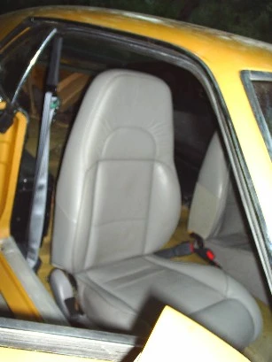

I've had a couple sets of Fox body seats in my car, including a set of Recaros from a '79 Pace Car and a set of '89 5.0 Mustang sport seats. Both had the adjustable leg support thing. The Recaros were supportive but the frame design was only supported on one side, so eventually the frame bent to the opposite side. The 5.0 seats were ok, but I found them completely lacking style (at least for me). Ultimately I decided I wanted a traditional looking highback seat that would kinda match the original Mach 1 highbacks... I chose these:
attachment.php
attachment.php
Some of you might recognize them... anyway, their leather and have the same frame/structure as Fox body seats with adjustable bolster and all. Same mounting procedure as Fox body seats too... drill 2 extra holes and attached my original seat tracks and bolted them in. I intend to get them recovered to match the original comfortweave interior, so eventually they should blend in quite well, and still have that classic highback seat look.
Hope this helps... :shrug:

I guess I'll have to post pics of my unfinished seat project tomorrow.
....and people said they wouldn't fit....muahaaaahahahaaaaaa
and I can lay the claim that I'm the first too.
front and back matching black sexy leather seats woo hooo.
