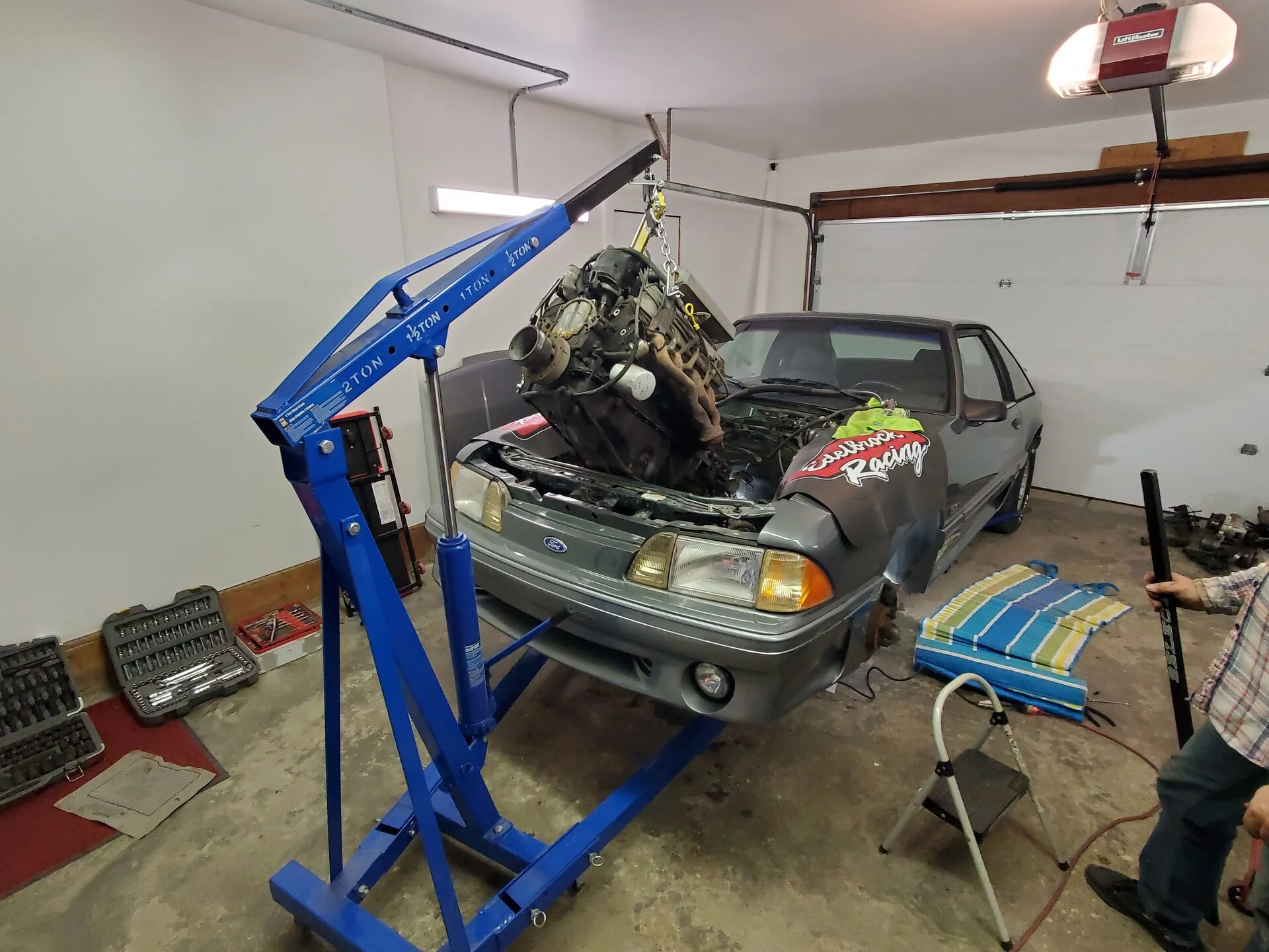

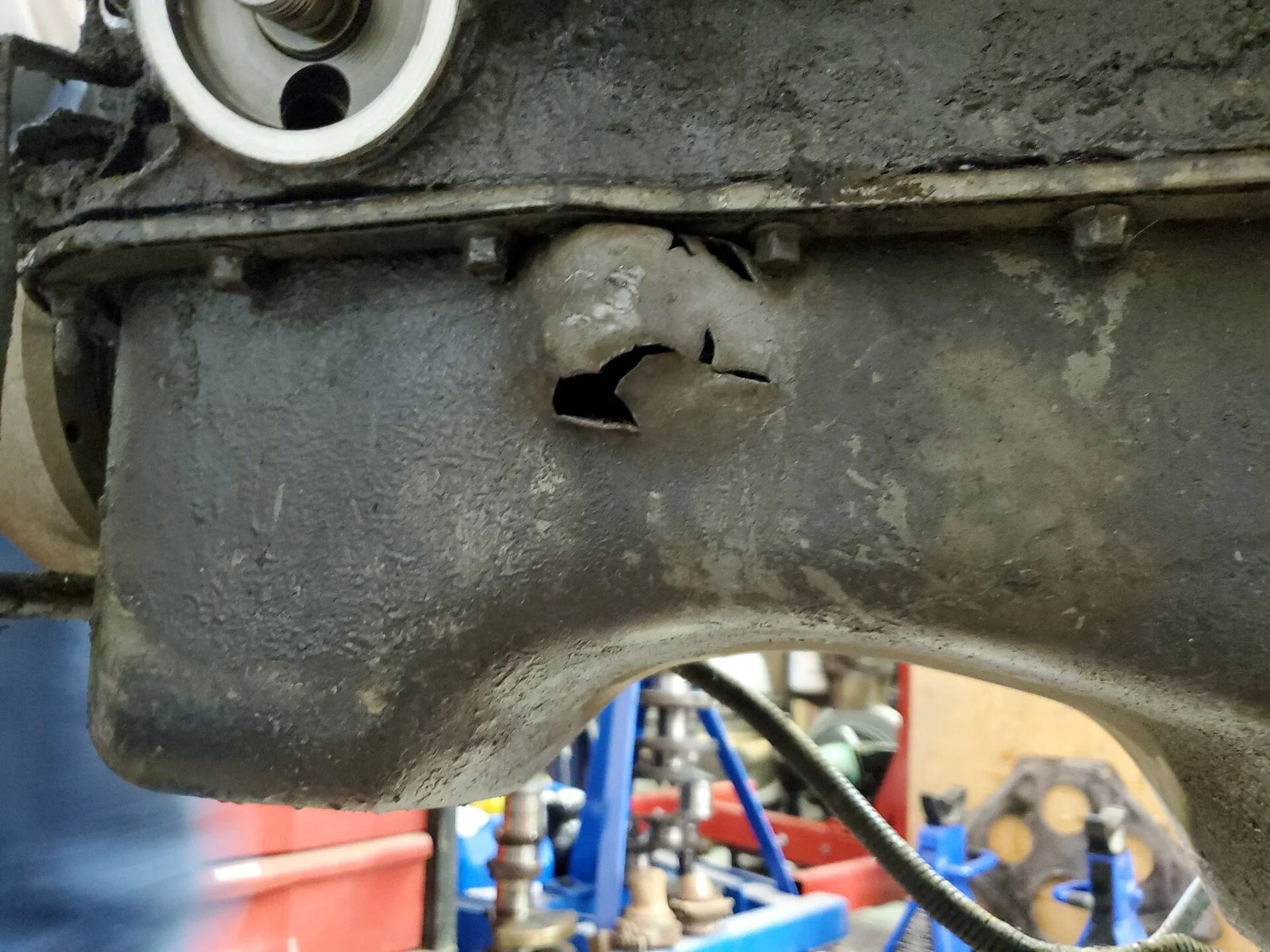

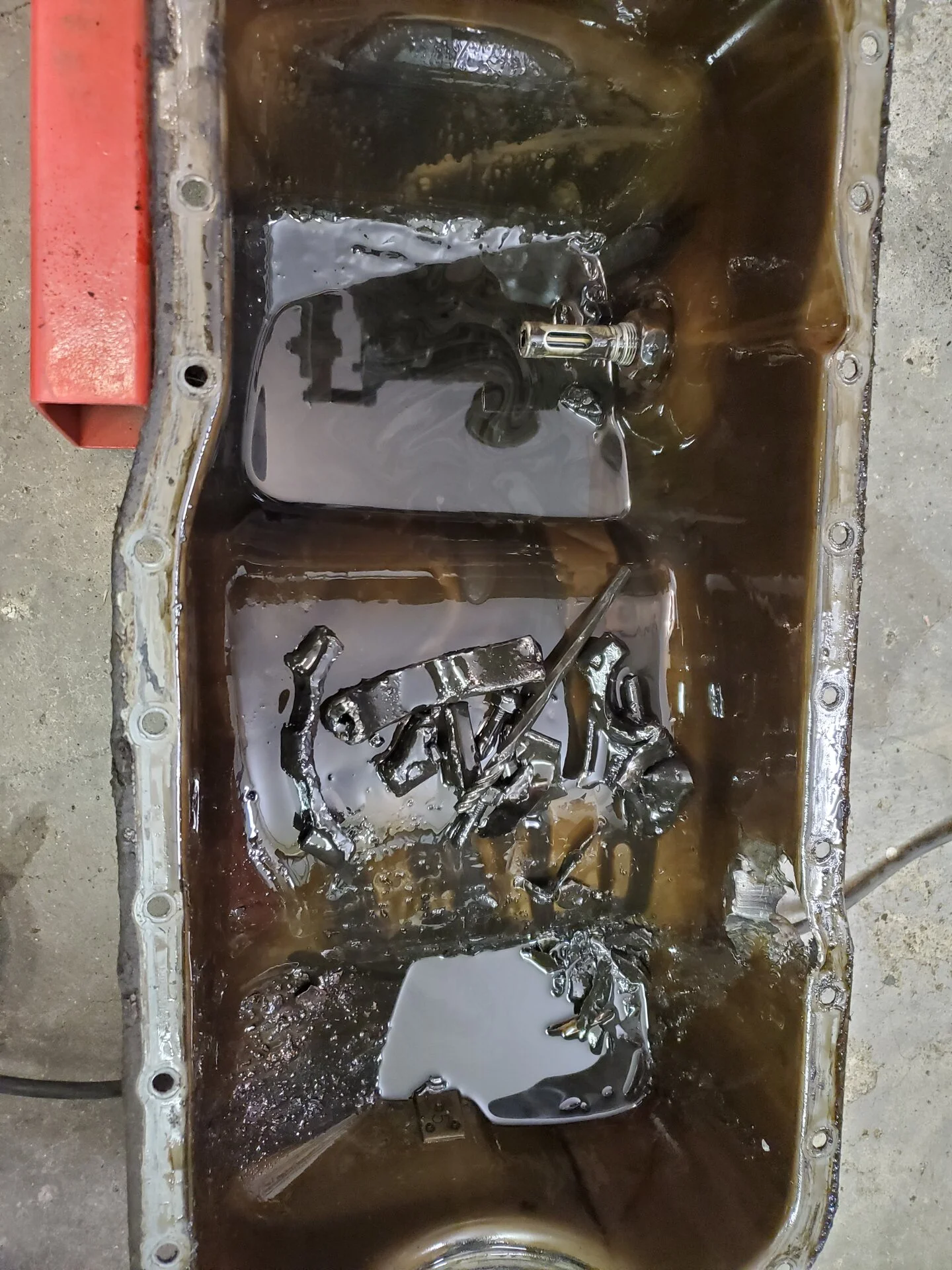

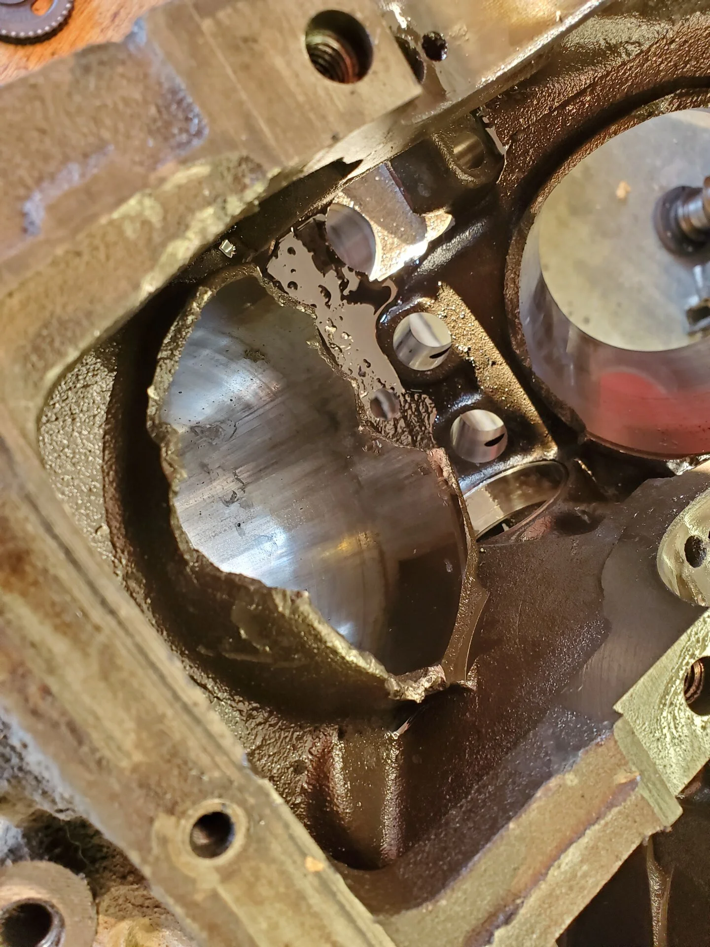

A month ago, I decided to tear into it and pull the motor and trans. I was greeted with a nice-looking hole in the side of the pan.

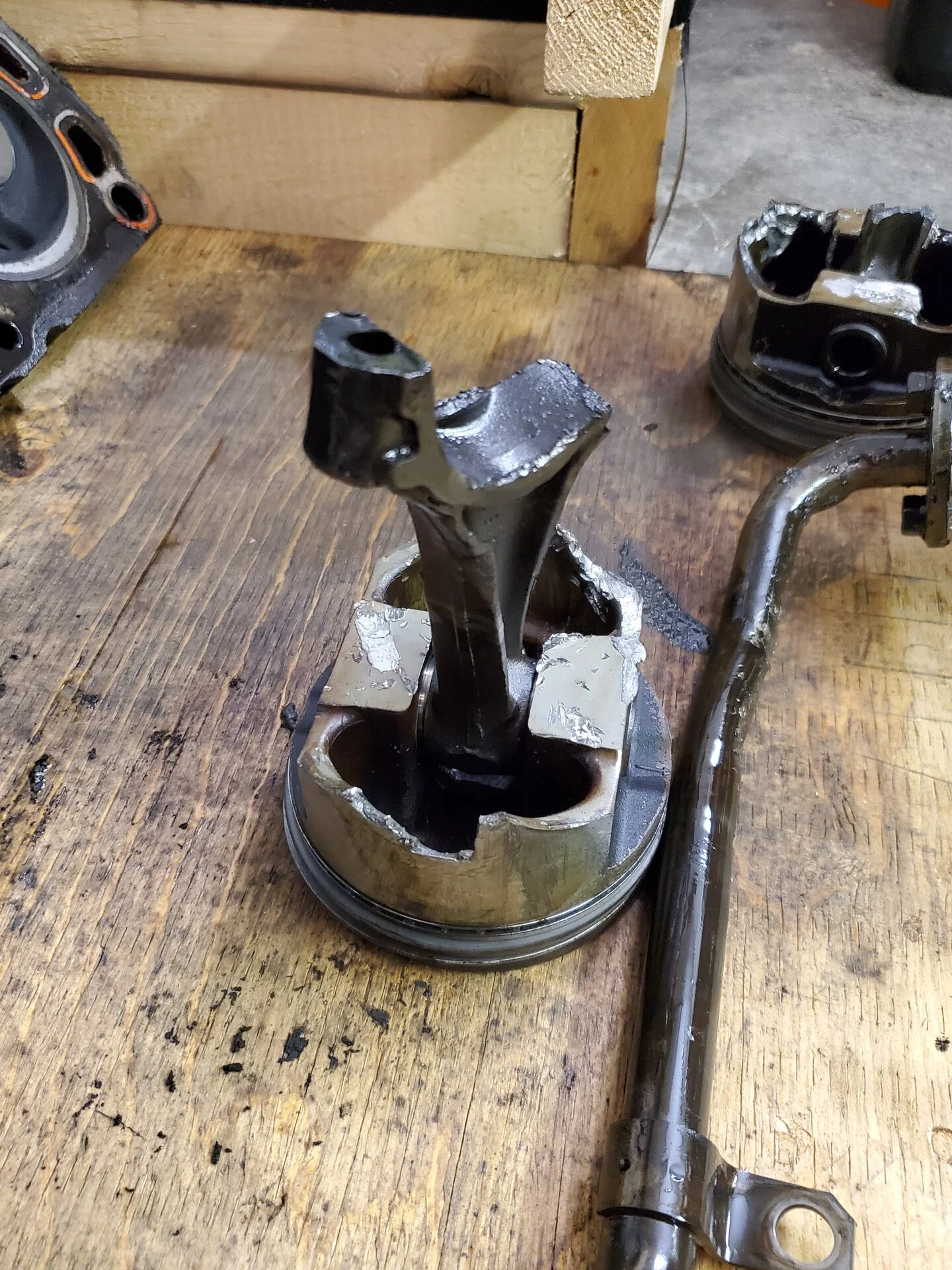

When I removed the oil pan, I found a bit of the rotating assembly laying in the bottom. I’m guessing that the oil pump shaft likely failed? Cylinders 1 & 2 were completely destroyed, and the others were on there way out.
I thought these 302’s were fairly indestructible? So because the block was toast, I was on the hunt for a new engine.

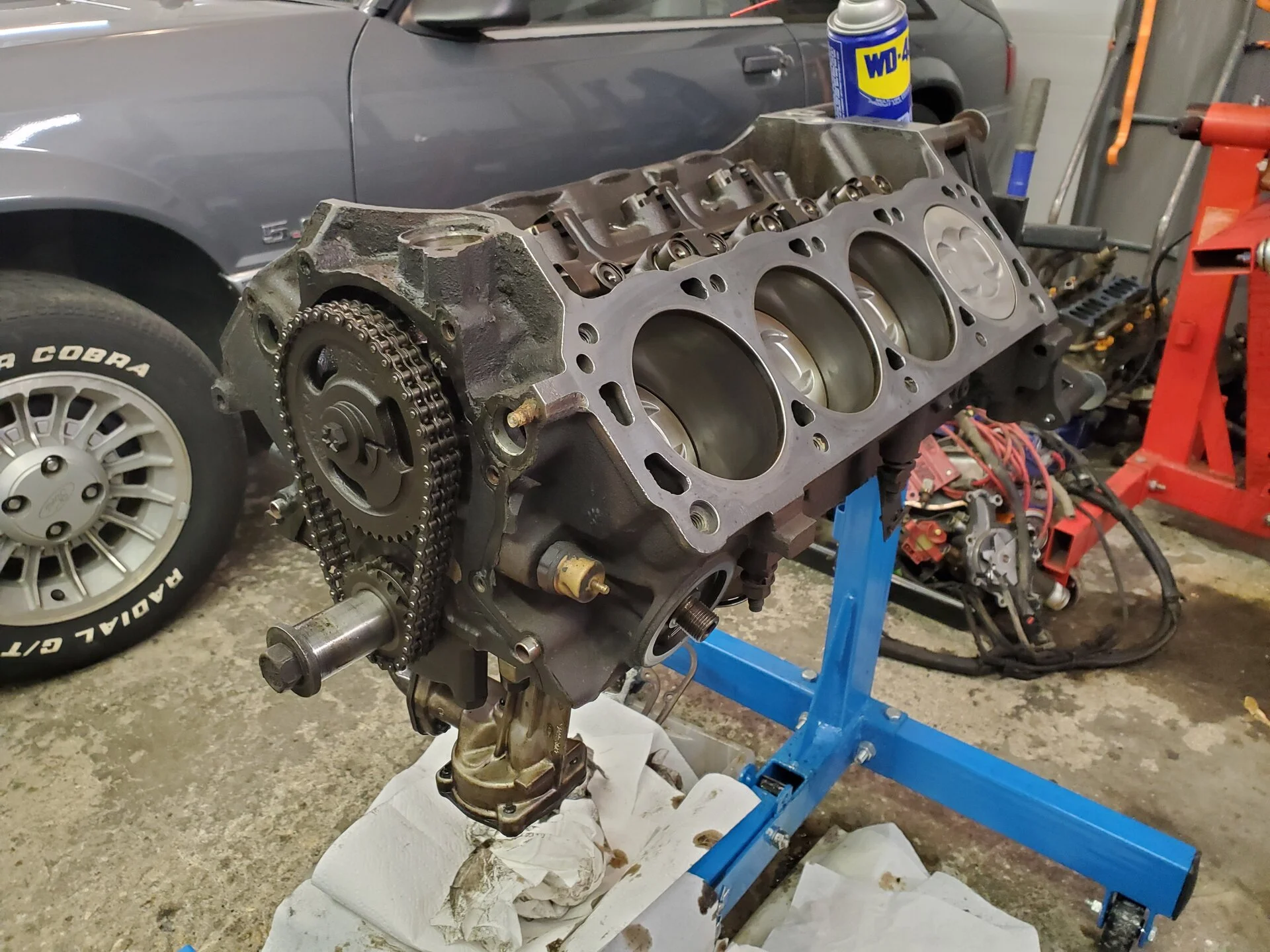

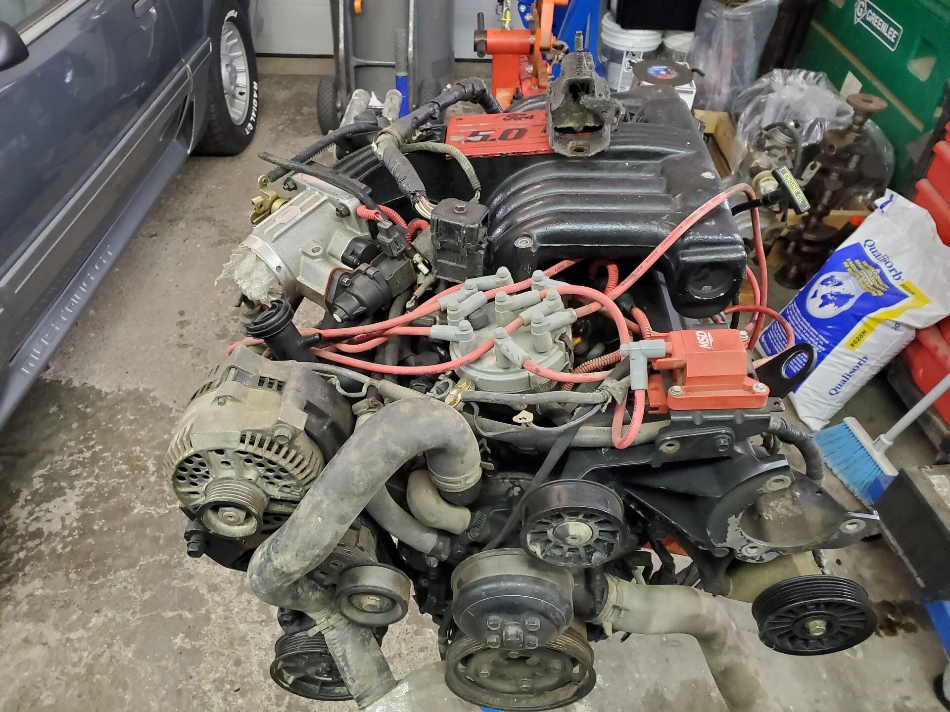

The only thing I could find near me was a 5.0 out of a 95 mustang with a 176,000kms on it. I did some brief research prior to buying it and I gathered that the 89 & 95 long blocks were the same?? Someone can confirm that. So the plan is to install the intake and front drive assembly off the 89 engine onto the 95 and swap it in. I am hoping that the stock 89 computer will run the new motor without any tuning needed.
If I’m already way in left field on this, let me know lol. I’ve taken the 95 down to short block form to clean it up and put it back together. The timing chain seemed quite loose so I have purchased a new comp cams timing chain and gears to install. I seriously debated installing a new cam but from everything I have read, it looks like it doesn’t gain you any horsepower and spending $700 for the sound wasn’t worth it for me.

Yeah, oil pan failure, it happens :jester:
you're on the right track, the blocks are the same, swap the 89 stuff over and enjoy the ride.
These blocks a pretty stout but there is always that 'stupid factor'.
