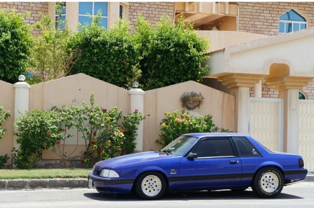

Dear stangers
I’m form United Arab Of Emirates, I own a mustang 1993 foxbody and I want to buy all requirements to swap to coyote.
Engine2015, gear, clutch, cpu, wiring, suspension, breaks, headers, Exhaust system... etc
The installing will be here in my country, all I need all the parts A to Z plus pro charger
I need a proper way do a coyote swap on foxbody mustang. a specific parts list of what will and will not be required, what parts I have use to properly install a Coyote motor in my Mustang,

I like your car. Looks mean. Not sure I would mess with an engine swap. Pushrod v8’s sound awesome to me. I get it though. Everyone is chasing more power. Seems like the number is so important to everybody. But you mentioned it being mostly a daily. Well the number isn’t as important to me at that point. Torque down low. A smooth steady idle. A pushrod v8. Isn’t your car fun to drive as is? Just sharing my opinion. Add to that I can’t afford a coyote swap.
I don't think people do swaps simply for the power numbers.
IMO, they do it more for the drivability and reliability.
There are plenty of ways to make big power with pushrod engines, unfortunately as the power goes up, so does the cost (drastically if you pass 500rwhp) and the reliability goes down.
If I had a dollar for every person I knew with a supercharged or turbo fox that blew a head gasket, i'd be a wealthy guy.
Around my way a good coyote is still fairly expensive, in a few more years when prices are lower we will probably see the swaps on a daily basis.
I know people find them cheap, but I think it's more the exception than the norm.

Honestly I love foxbody coz it’s my first car which I bought when I got a driving license “OLD IS GOLD”
Swapping to coyote coz I can easy challenge the new generation engines
Hey guys thanks for your advice, I took it so serious and I did my research on Google and also with some workshops.
My 1st step is to 2 up to swap to coyote engine with T5 gear
2nd change the suspensions break system and upper lower control arms
3rd repaint the car
4th change the Pistons to low-pressure with supercharge and smoth cams
I will add all the list of parts which I will use and the cost, to help someone else to swaps easy to coyote.

Do the brakes and suspension first. It will make the car safer and more enjoyable.
While you are at it, goto 5 lug. If those are skinny's up front, lose them, especially since it's a daily driver.
You will be essentially doubling the hp of the car by going to a coyote engine, stopping and turning will be far more important.
If you need help with suspension parts, just look through the maximum motorsports catalog.
Just don't buy the k member as of yet.

Thank God someone else fixed that before I saw it...
OP:
DO NOT add more power to a car that cannot turn or stop in a reasonable fashion for the power it already has. ALWAYS fix the chassis and brakes first, always. As mentioned, just get a maximum grip box from MM and call it a day. That's the easiest problem to solve for you. Call up Jack at MM, tell him your goals and give him your debit card info.
