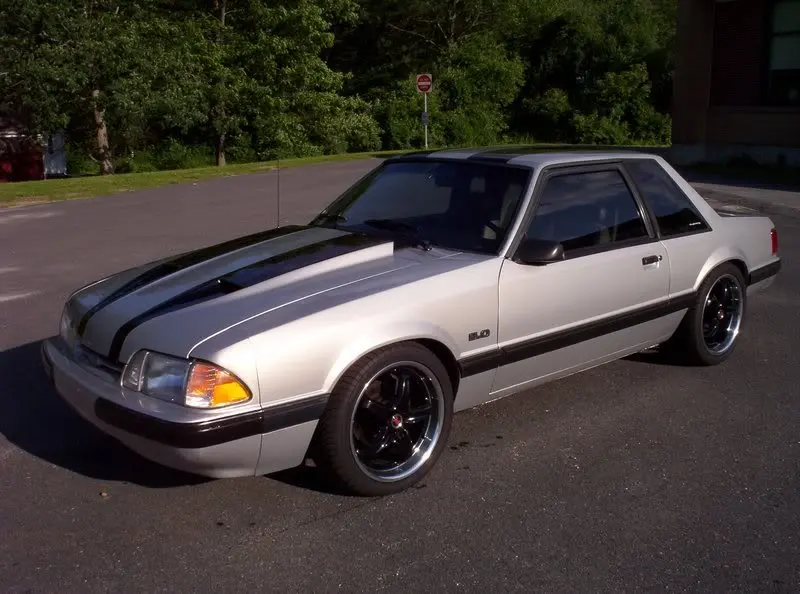

Jan 11, 2007
  • Jan 11, 2007
Busted07
I need my gorilla to be about an inch longer.
Nov 15, 2005
Jan 11, 2007
  • Jan 11, 2007
GearHd6 said:
Thats the stance i want!!! What size tires are those if you dont mind me asking! and the BBK springs... what rate? what shocks etc...
Edit: im reading your car domain page now
I
iwashmycar
20+ Year Stangneter
Apr 7, 2004
1,236
39
Columbus, Ohio
Jan 11, 2007
  • Jan 11, 2007
that does look pretty killer. love the stripes too.
edit: cant get over that style of hood tho.....never been a fan. but...enough of my opinions lol

Ok, i looked at your car domain page and it didnt say exactly which BBK springs you had... would you mind letting me in on that?

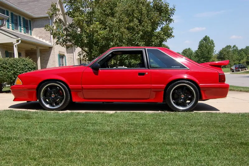

My '89..
235/40 on 18x8 and 275/35 on 18x9
