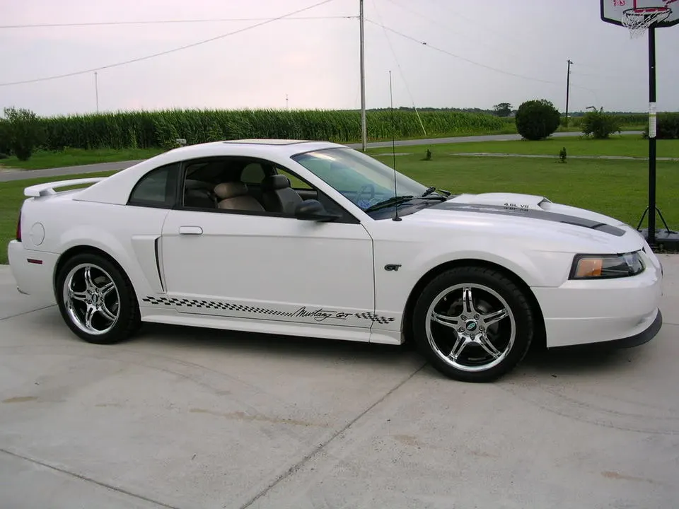

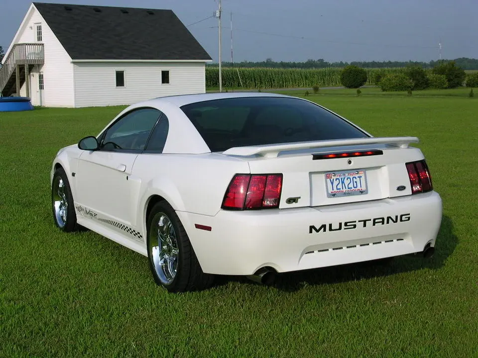

As far as if you should go stagered or not depends on how much drive it and if you want to rotate the tires. I have 285 Nitto's on 18x9.5 wheels all the way around. It looks great, handles very well and I can still rotate the tires. It's also a dd with 98K on it, so It really pays to be able to rotate. That being said, I really dig the stagered look, just not practical for us. Just my opinion.
