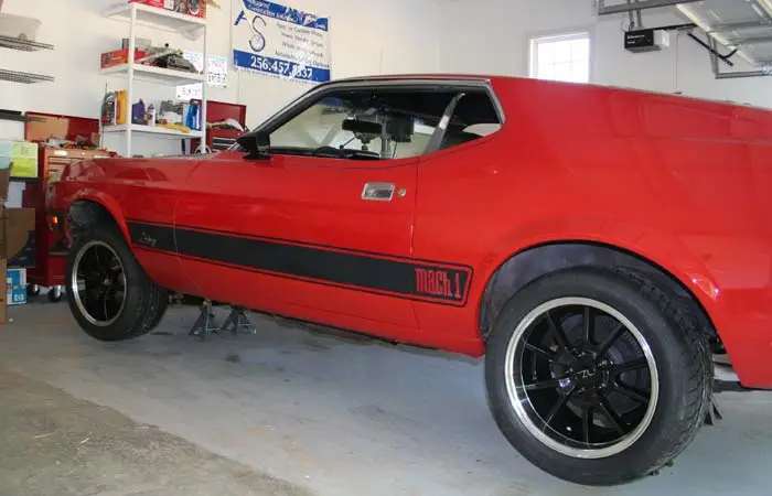

Got them in the other day, 315s in the rear. I need to put longer wheel studs on, and the front hub needs a little massaging for the center cap to go on. Other than that fitment is inside the wheelwell, but I might have to roll the fender once I get it on the road. I'll have finished pictures in a couple days.

Doh! I forgot to look at the tire size before I left. I can't remember the ratio but it's 275s in the front and 315s in the back.
Of course I'm going to leave the drums back there. They work so well and look so good, that, uh, yeah I'm going to swap them out soon hopefully :lol:

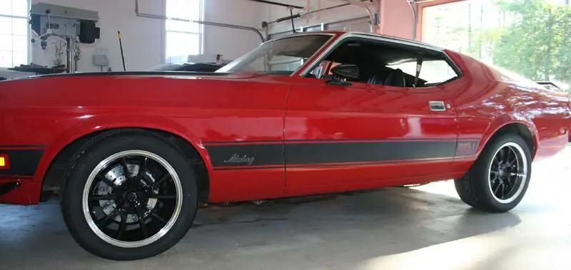

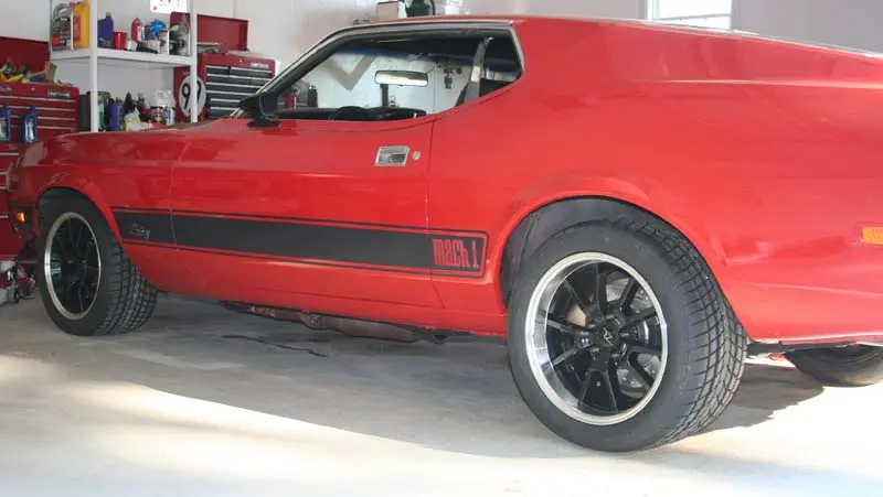

Some pics.

I gotta laugh, but in a good way, that you couldn't find $20-$30 worth of wheel studs that would work, so you spent a couple thou on new brakes. The funny part is that it makes perfect sense to me, and probably to everyone else on here.
BTW, the wheel-brake-tire combo looks awesome. I'm always saying to anyone who will listen that the big Stangs look great lowered with fat tires. You still need to take care of the lowering part, tho. (Here's my car, with some similar looking wheels, before I lowered it another inch)
Looks very nice, I was able to get 315's on the back of mine with rolling the lips. I just wish I could get 275's on the front so that the look will be balanced. Post up more pics once the car is on the ground. :nice:
If you switch to the '73 lower valence you will have room to run 275's in front. Mine has 245/60/15's in the front and they never rubbed with the '73 valence. I put on the '71 valence, got a little tire rubbing when turning.
The front brakes weren't too bad, 650$ shipped. I went ahead and bite the bullet and ordered back ones since drums wouldn't look right behind the wheels.
And on the front studs, I drove all over town and looked in every catalog for a knurl that would go through the hub & far enough into the rotor. Couldn't find it. Maybe I missed it, but it was a good enough excuse to buy new brakes :) The rear studs I bought and had pressed in; they worked fine.
