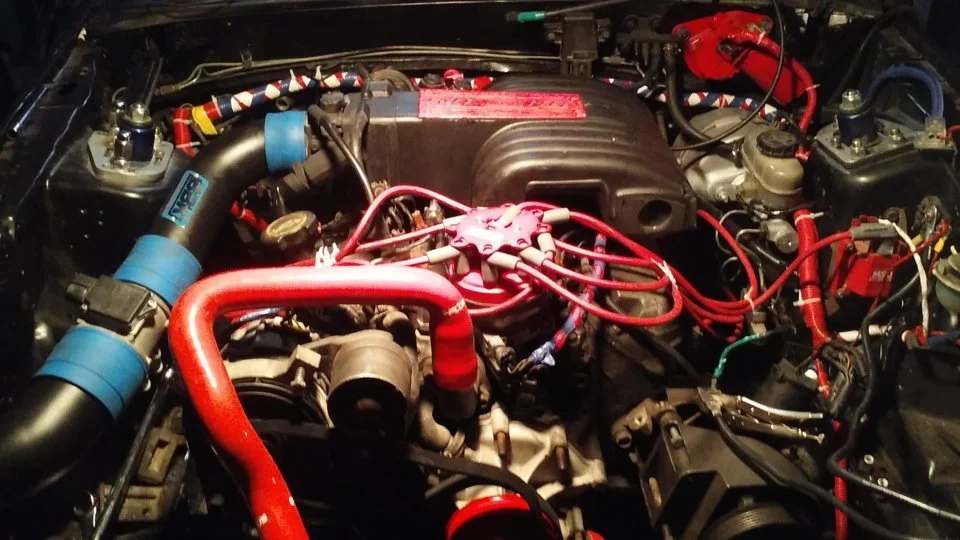

Here is my 88's heart

Pedestal rocker arms on Twist Wedge heads? I thought all TW heads utilized stud mounted rockers?

Those heads will do just fine on a 308. I made quite a bit of power with them and they are small for my motor.
Good call on the rockers @Gearbanger 101 .

Early versions of the twisted wedge did in fact come with pedestal mount:
http://www.stangnet.com/mustang-forums/threads/trick-flow-twisted-wedge-heads.796531/
