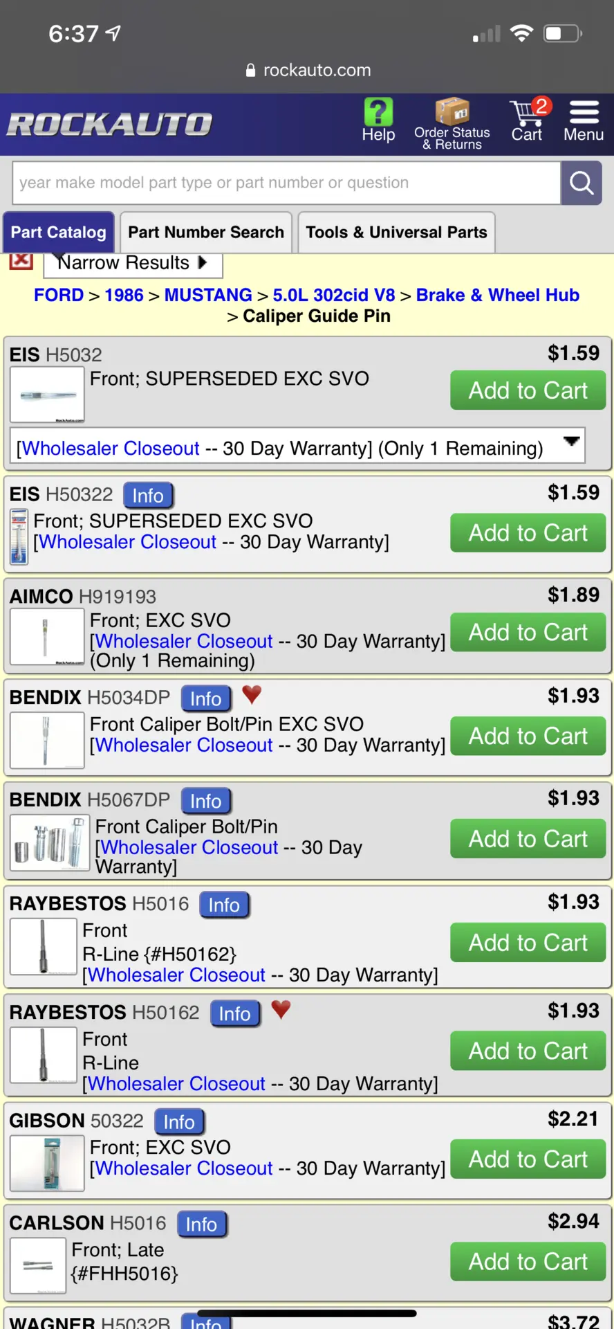

you can buy that pin separately. Usually come on a caliper hardware kit.
edit: plenty to choose from
