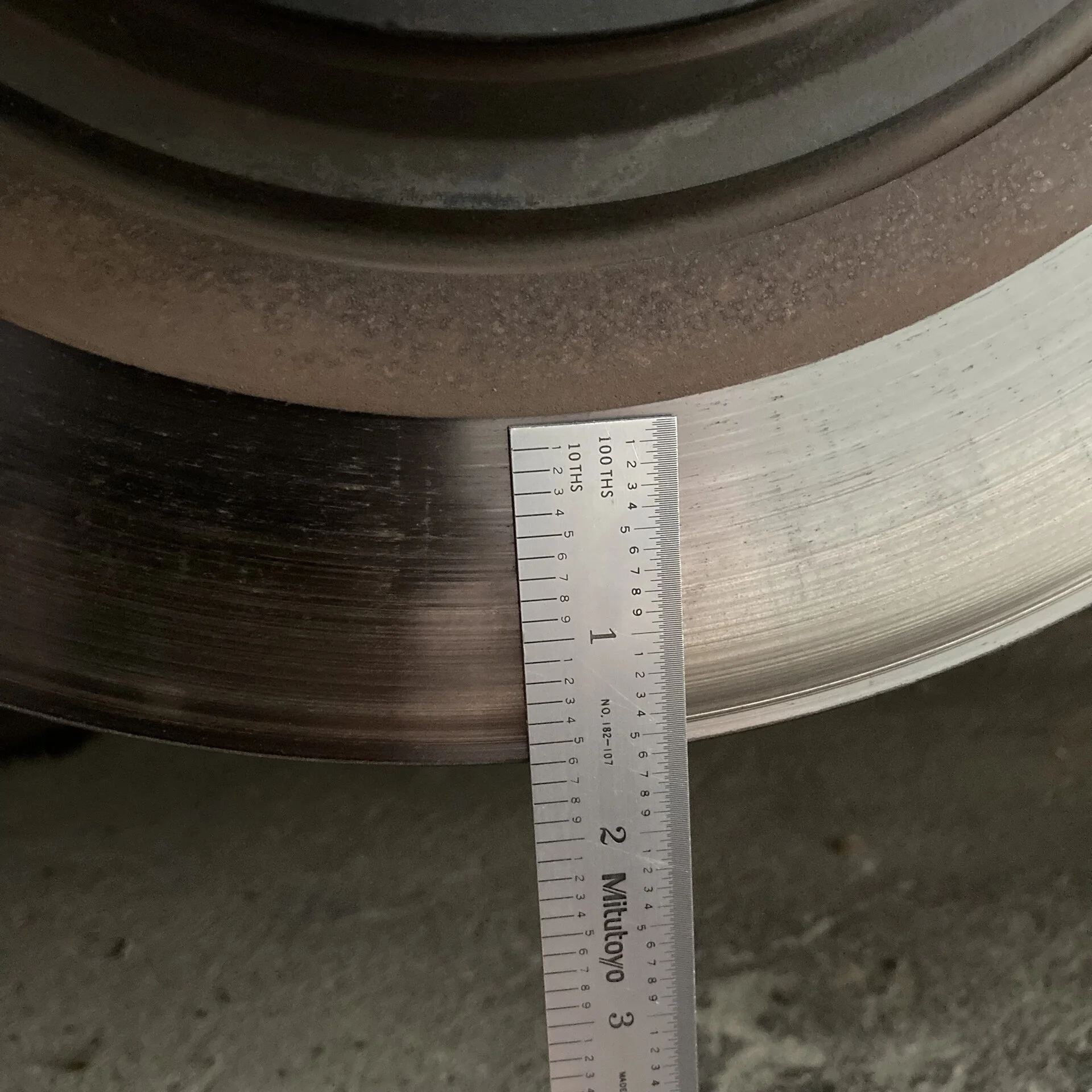

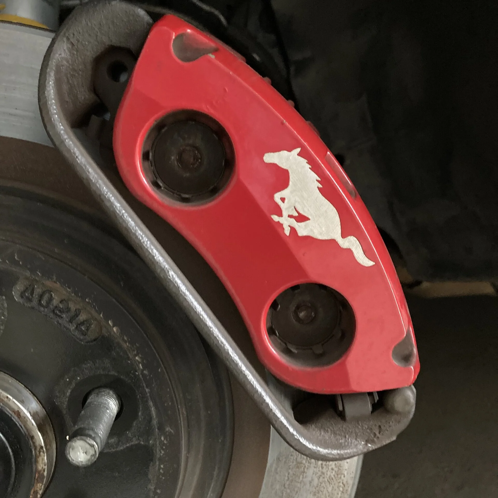

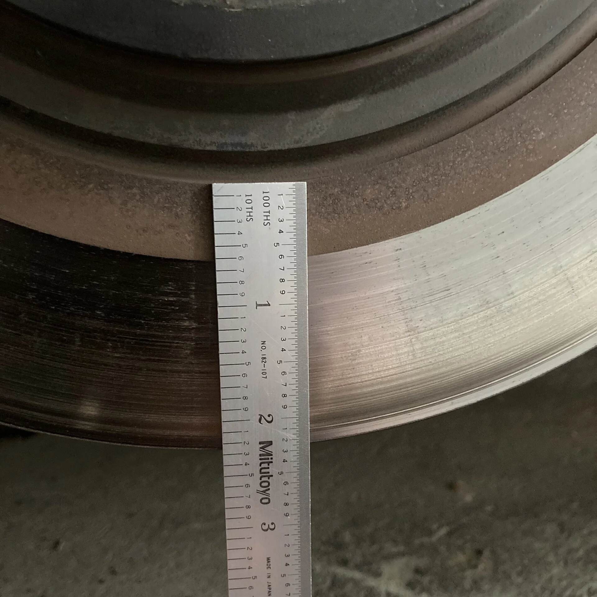

Hi All,
I have this issue/question about my front brake pads. My ride is a '90 GT with the '01 bullitt mustang brakes upgrade. Looking at the disc wear or the pads contact it seems like the pads are too narrow and more disc surface could be effectively used. It seems that the performance set of Hawk pads are wider than the stock ones, is that real? Or are there any other good wider pads I can use to add more braking power?

I have 3 foxbody mustangs all with 5 lug and cobra brake conversions. They all look the same as yours as far as pad surface contact. I think it is just the way they were designed. I have not experienced any pads having a different contact area than stock. For me the best pads I have used are factory ford pads.

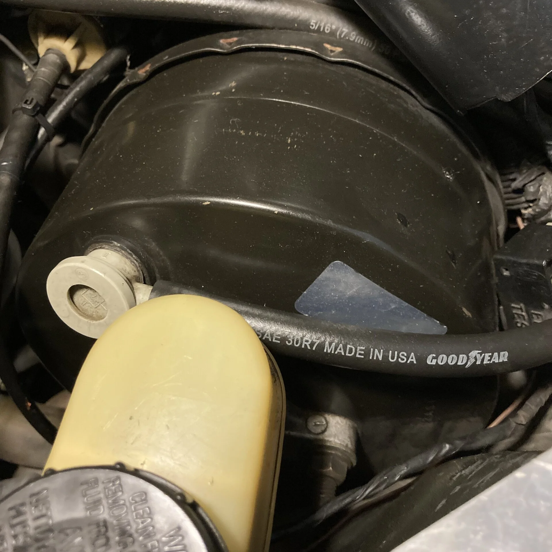

What brake booster are you using? If you have stock foxbody booster that is your issue. You need a 93 cobra booster or a 94/95 booster. A stock foxbody booster will give you a hard pedal. The master cylinder you are using is fine.

By God that don’t remember, I want to say that it is 94/95 but I did upgraded it.
Maybe I was expecting much more better stopping power.
This is the BB I have…

This question comes up quite frequently actually.
The 94-04 Cobra PBR was initially designed back in the 80's to be used on a 12" rotor. GM then used it on a 13" rotor along with Ford. SO the lack of full swept contact area is an artifact of the design being that it was originally intended for a smaller brake package.
PBR later updated these calipers to the style found on the C5 and C6 corvette. They used the same pistons, but allowed for a pad with a MUCH larger contact patch area for the 13.4" rotor. I actually have a set of these on my car because the lack of pad area on the cobra calipers drove me nuts.

I was reading your threads on this subject and have to throw this question: Is it possible or have you ever tried to fit the front Cobra or Bullitt calipers with the C5, C6, or GTO brake pads for more braking surface area? I would be interesting to know about that possibility. Wouldn't that be great??? :)
The pads don’t interchange. The design of the calipers is different. The cobra calipers are a pad guided design where the pad is wedged into the abutment bracket and the caliper clips to the pads. The corvette style are pin guided calipers where the pads are also wedged onto the pad bracket but the caliper rides on two libricated pins and doesn’t physically connect to the pads. The pad area is dramatically different too.
unfortunately you are limited to the cobra style pad here
