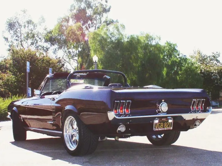

I have a 67 vert, with 620's, I cut 2/3 a coil off with my shelby drop and konis, the ride was fine. I changed to GW UCA's and roller perches and had to cout another 1/3 a coil to get the drop I had before and it rides nicer than it did before. On a 70 the wieght is more like my vert, I do have a 408 stroker but with alum heads and int. Maybe with a lighter wieght eng it may ride slightly stiffer but I cant see it being too stiff.
I run my konis on 2/3 stiff, have an 1 1/8 sway bar and it rides very nice, its very smooth, its like a slightly firm yet contolled ride much better than stock in my opinion
