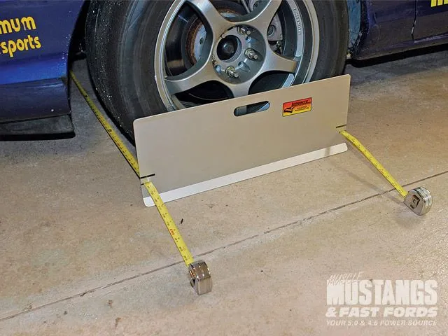

Let's also clarify - I believe what you are talking about is toe adjustment, correct? As you look at one (front) tire, it looks like it is aiming straight forward, but then if you look at the other tire, it looks like it is turned slightly outward. Is this what you are seeing? As crazy as it seems, this is just an illusion. You've verified the measurements, correct? That proves it. If you have not, you can simply measure toe as shown here...you can sub the gizmo they used with just a large level, a yardstick, or a very straight 2X4. Make sure they are flat against the tire/rim and then compare your measurements.

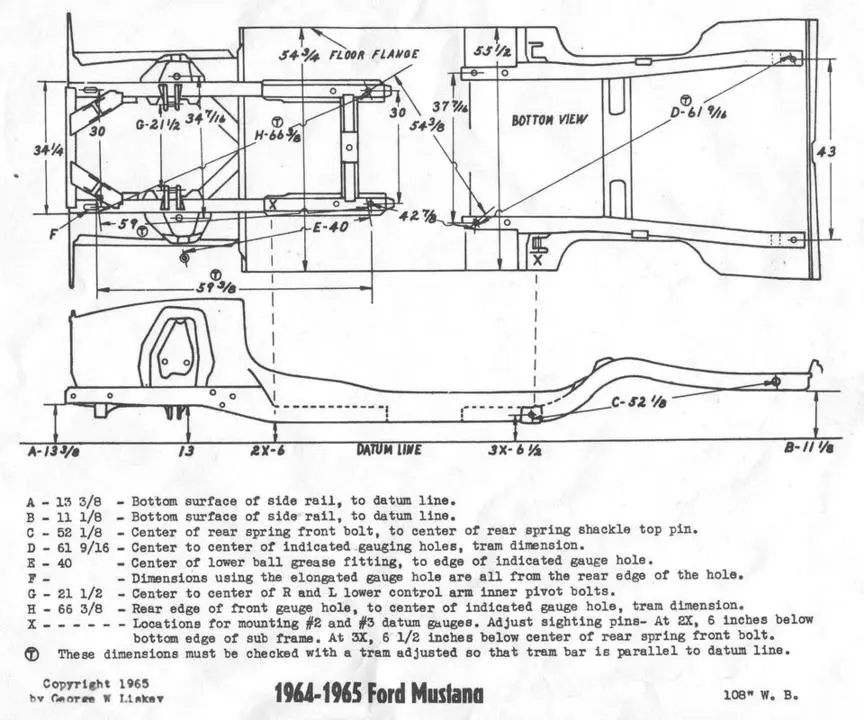

All modern cars have specific points from which measurements can be made to determine the dimensional correctness of the frame (squareness etc). Here's a sample from an old Mustang:
Sorry...I have no idea why it's so huge!
A good bodyshop with a frame rack should have access to the correct dimensions and points for the Fox-4 chassis. If it's really bugging you (I get the OCD thing... :) ) you might consider putting the car on a rack and having it measured.
I still believe the "problem" -- if you will -- is in the K-member and/or lower control arms. Then again, this is a Mustang...it's possible it's simply that the body panels aren't lying symmetrically left-to-right over the chassis causing the appearance you're seeing.
