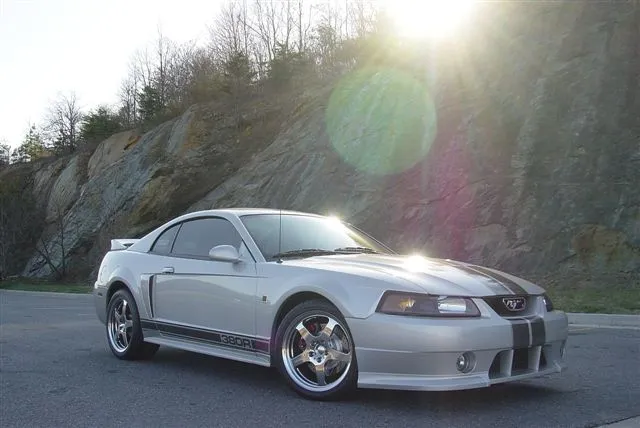

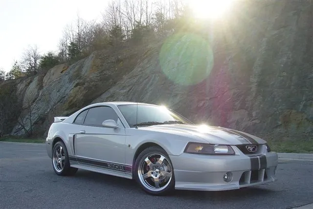

I like the B springs ride is great I just wish the back was 1/2 inch lower
