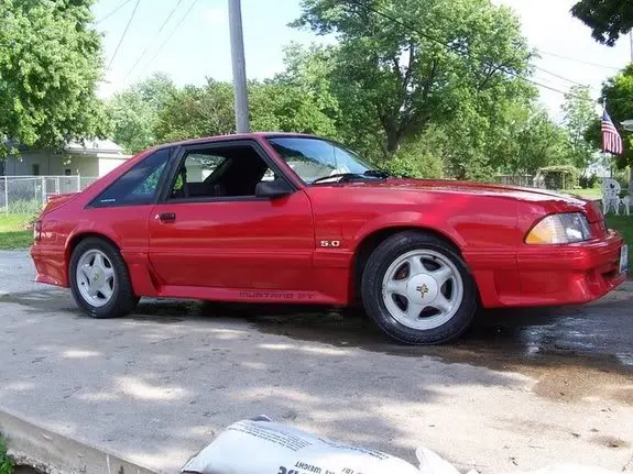

Here is mine with C springs.

Kumm3- did you cut the rears springs or leave them like they came? the front of my car sits really high now, maybe an inch or so higher than the rear, so if the front is lower when i am done, i will be ok with that, i like a little rake myself...

They are unmodified, using all the stock isolaters.

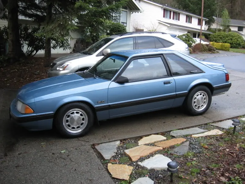

Here's mine with B springs:
The back defniitely sits higher than the front like other people have said.
The B springs ride pretty well. I was expecting them to be stiffer. I bought B's because I wanted my car to handle like my last 5.0 (which I THOUGHT had B's), but the B's in my current car ride a lot softer than the springs in my old car, so the old one must not have had B's after all.
The B springs are a pretty good comprimise, they definitely aren't too stiff.

mine is pretty lightwieght up front in those pics.
Aluminum heads, battery in back, spyder intake which is a little lighter than stock style ones.
the rear is pretty light too, no sound deadening, spare tire, jack, rear seats or brackets.
