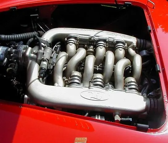

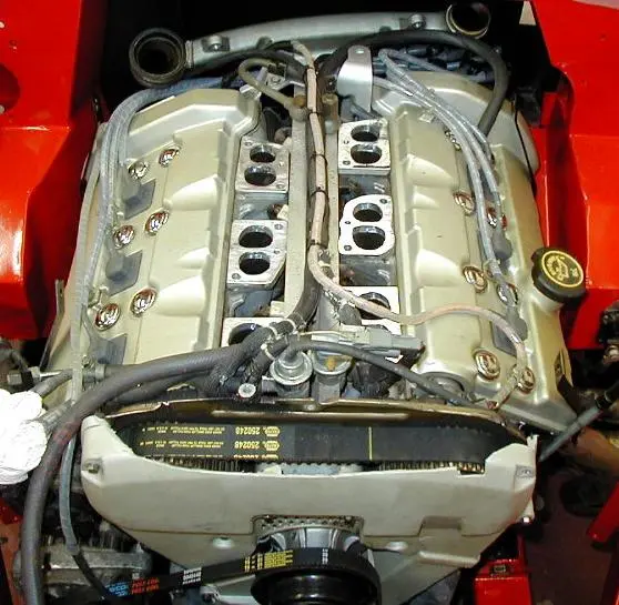

On the 4.0L intake manifold height...if it doesn't have a dual runner per intake design (i.e. one short for high rpm, one long for low rpm with a butterfly valve to switch), then you should be able to make a new lower intake with aluminum tubing. You just need to know someone with a tubing cutter and TIG welder. :)
If you look at the aluminum 3.0L SVO intake, you can see that each runner is aluminum tube connected to the port plate on one end and the plenum on the other with a silicone boot. It all fits very close to the valve covers.
The attached pics show the SVO 3.0L V6 install in an Austin Healey here: http://members.cox.net/rdgrauman/Healey.html
