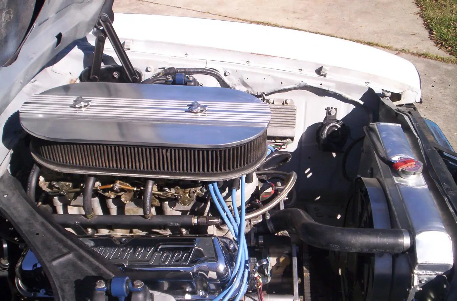

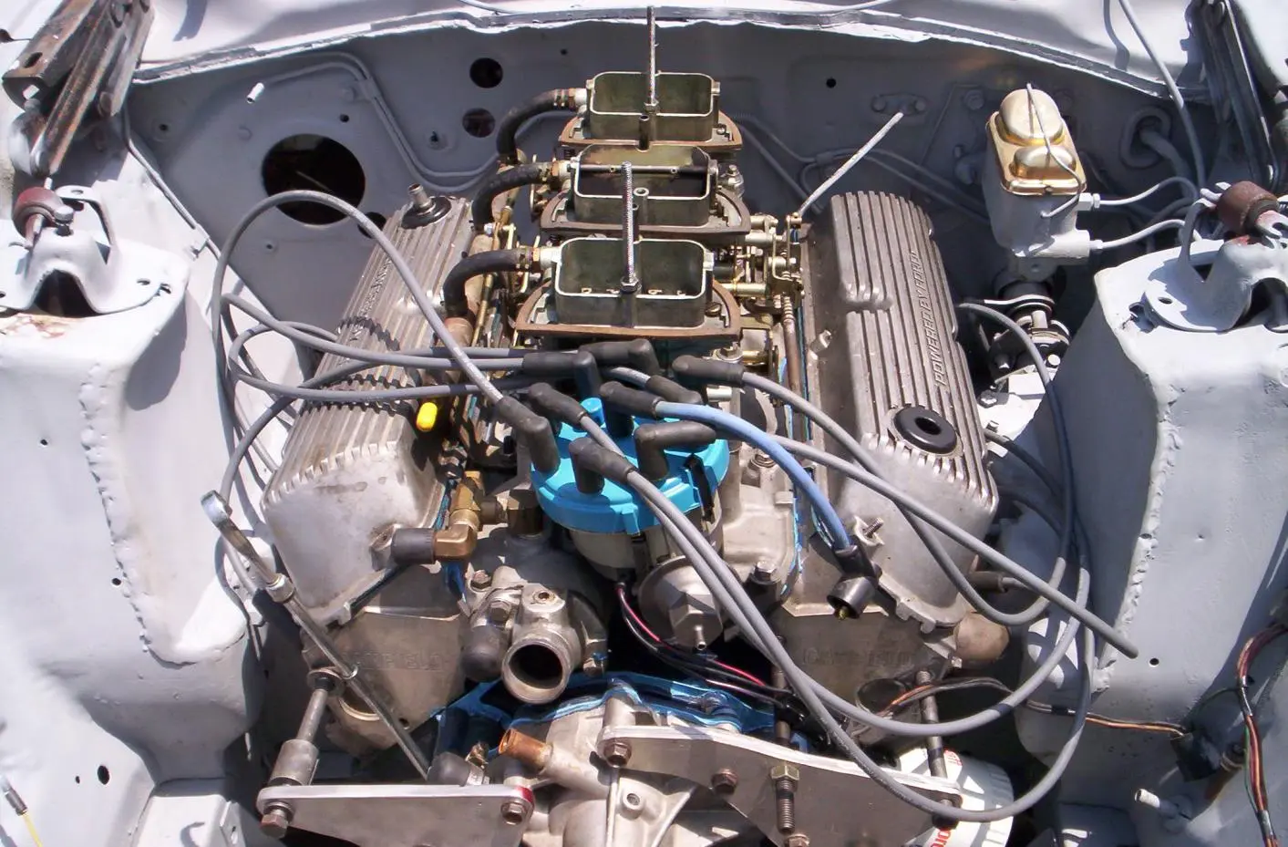

Yea, but this will look even better ;)
That is very interesting. So it looks to me (I'm an incredibly noobish person when it comes to this sort of thing) you have three carbs on top, and then I imagine your EFI system is somewhere on the block.

Of all the above, only the altitude correction is true. Weather changes ? B.S. Cold starts? B.S. Fuel economy is only partly true. But who's going to drive their classic enough to care ? Tuning those three carbs took all of an hour.(and that was changing jets in all three) And that was 6 years ago. Ain't touched em since. They're no more trouble to tune than hooking up a laptop.

That's a 3 carb setup with Holley 250 cfm carbs. No EFI there. The ignition is a stock Ford Duraspark. Throttle response equals any EFI system. MPG? they pulled down 16 mpg highway @ 70 mph with no overdrive in my 89 Ranger. 14 mpg in the Comet with it's C-4 transmission. The Ranger had a Toploader 4 speed. No overdrive in either vehicle. Cold starts are no problem even with no choke (all that's long since been removed) Give it a single pump shot, then baby the pedal a minute or two and it'll idle on it's own. The 5.0 currently in the Ranger is an Explorer 5.0 topped with a Ford A321 intake and Holley 570 carb. Also, no choke there. Cold starts & idle down to 25*F with no babying of the pedal, again the secret is the EFI cam grind (Ford's F4TE hyd roller) and a good electronic ignition system (it's got a Crane XR-1 in a points distributor) Both have been extremely reliable, tuneups go 2 years or better between plug changes. And no carb adjustments once the initial tune is done.

What ignition system were you running with that old 351W ? As for the cost of my tri-power, it cost me $1100 shipped to my door. It was a year old, bought second hand. The same setup new, now runs about $1700 (Mustangs Unlimited) The 5.0 in my Ranger with it's 570 runs as well as the tripower. I've yet to have the chance to check the mileage (hopefully that'll happen this week) as I didn't have an operable speedometer with the Toploader 4 speed.(it's got an SROD in it now) The mileage of the 331 (when it was in the ranger)was checked without it, but on a measured round trip from my 06 Mustang. Bottom line is you can have most of your cake and eat it too with a carb. It just takes the right combo. It's all in the cam choice, ignition and a smaller than normal carb.

The downside to EFI is when it goes wrong. If you don't know how or have the tools to fix it, it's going to cost you an arm and a leg to get it fixed. Multiple carbs gained their bad rep from being paired wth points ignitions "back in the day". 90% of what everyone thinks are "carb problems" are actually caused by the ignition system. The 3x2 works as well as it does due to the running on the center carb all the time with the end carbs being the secondaries. It's basically like a spreadbore carb, but with better fuel distribution. Something I'd like to try someday is Edelbrock's airgap 2x4 setup. but with two 2 bbl Holleys or twin EFI throttle bodies. Or maybe that BG carb you liked to with a pair on a tunnel ram intake.
