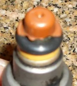

Today I change all my lower injector o-ring gasket and found 2 of them on the passenger side have problem . Look at the picture and let me know if it's ok to use as it is or I should buy new ones. Orange plastic cap is cracked in half.
they are NOT ok to run like and you can buy the "pintel caps" in a repair kit from ne1 who sells Standard Motor Products, part # is HK-9325

I would buy new caps for sure.
Ouch, I would buy new ones and save the trouble.

checkerauto got them so I order 2 set. they sell with o-ring gasket so it was $6.99 at their store, will be here thursday.
My car is whistling for more the a year now and I change everything thinking it will solve the whistling problem but didn't , now I know why is whistling. I changed all the o-ring gasket yesterday , whistle is much quiter now but still there . I think after I changed that cap my problem will go away. Wish me luck, I will let you guys know if that caps help
