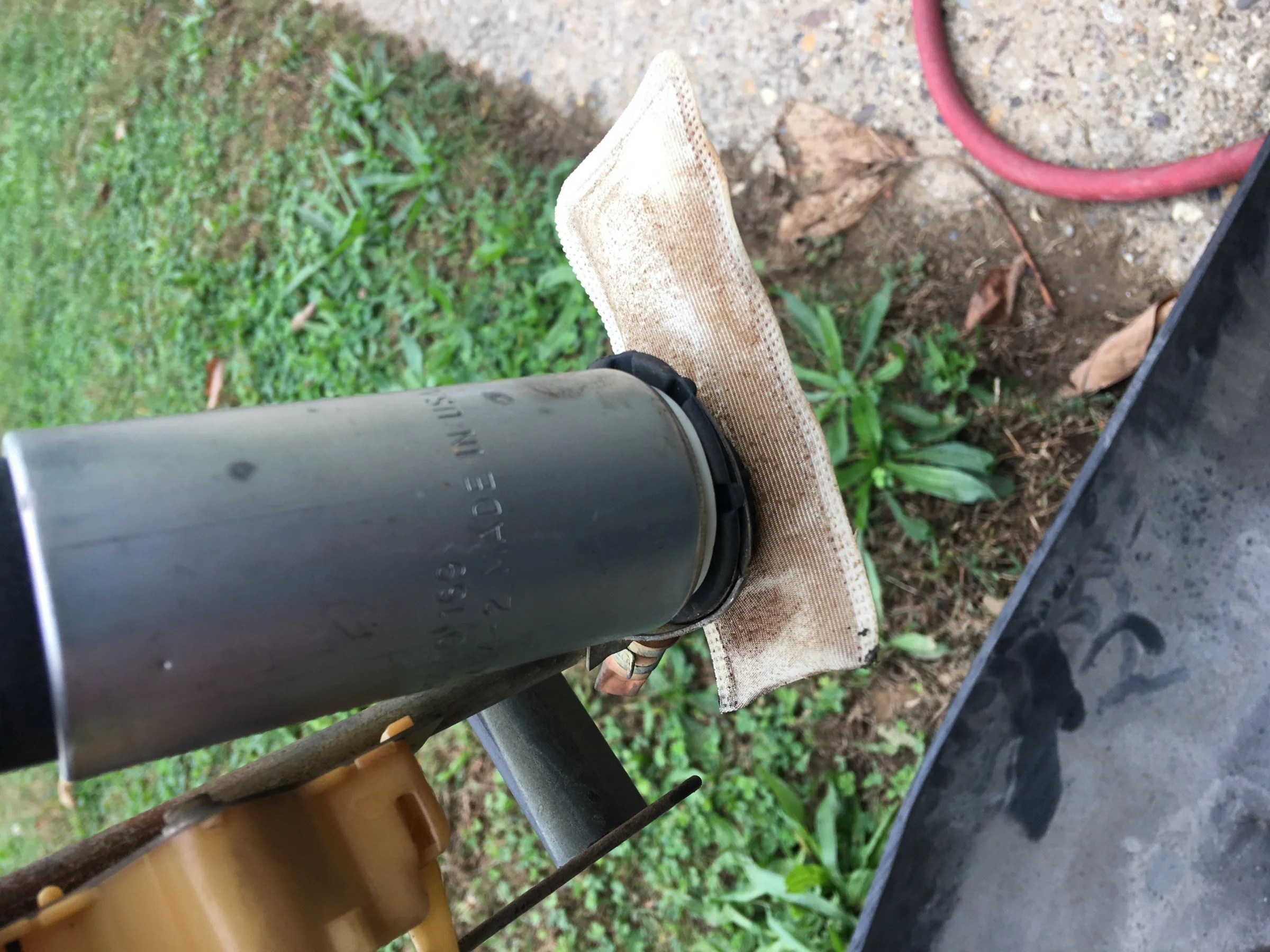

Ok. The build isn’t on this forum, so a quick recap of what’s relevant. I bought a new tank. Spectra f2c. I couldn’t get the straps to reach the mounting bolts. So I just went with the original fuel tank. Bad move. Apparently there was a rust and scale buildup that clogged the strainer on fuel pump. So the new tank has to go in. I don’t understand why Ford couldn’t make these bolts 1 inch longer. They are more like studs pressed into small metal plates. Well I have to do what Ford didn’t. I am taking them to work, pressing those short studs out and putting longer bolts in and welding the bolts to the plates. Aaargh!

That is what a clogged up fuel pump strainer looks like.

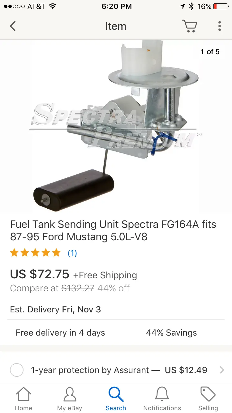

On a side note in case someone wishes to pursue a similar build the tank is spectra f2c, and the pump is a walbro f20000169 which flows 255lph. Would you believe even the fuel tank straps are still available?! Too bad the sending unit is no longer available. Airtex used to manufacture an aftermarket sending unit under the part # e2146s.

Spectra makes a sending unit as well
Reactions: 90sickfox

Sorry. Some confusion here. The Daddywagon is a 1985 ford ltd station wagon built upon the ford fox chassis with a longer wheelbase. The tank, straps and sending unit I am referring to are for that ford station wagon. They will probably work on the 1978 and up fairmont/zephyr wagons as well.
