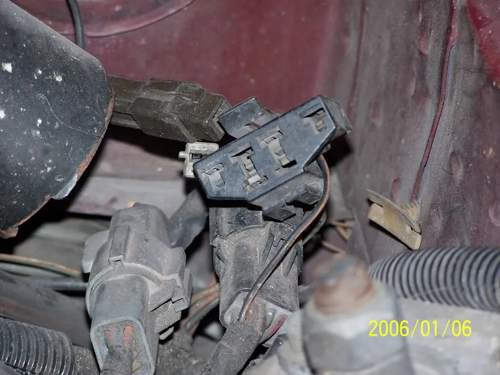

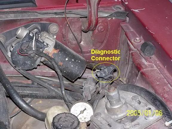

Clue – listen for the fuel pump to prime when you first turn the ignition switch on. It should run for 1-3 seconds and shut off. To trick the fuel pump into running, find the ECC test connector and jump the connector in the upper LH corner to ground.
Foxbody Diagnostic connector
foxbody-mustang-diagnostic-connector-jpg.586766
Foxbody Diagnostic connector close up view
foxbody-diagnostic-connetor-closeup-view-jpg.586765
Turn the ignition switch on when you do this test.
