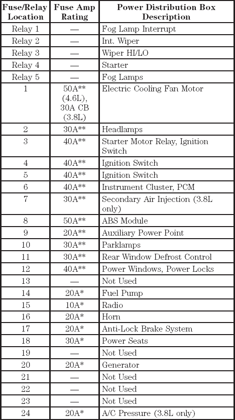

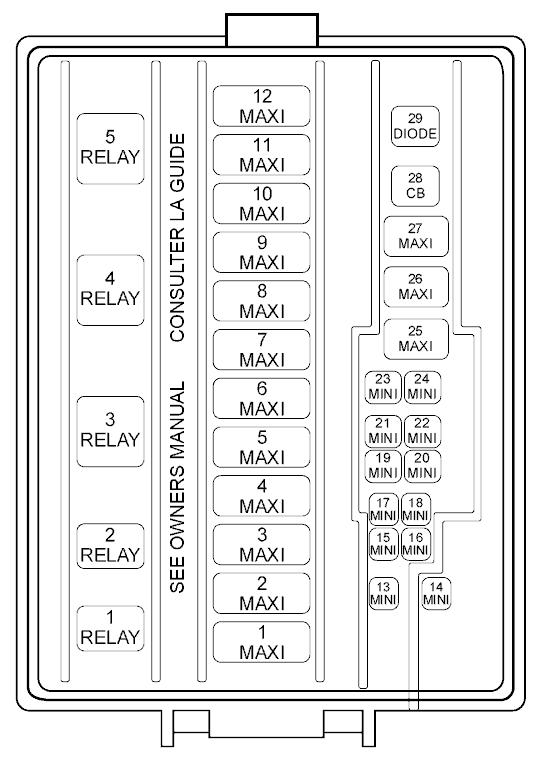

I have a 2001 GT but I do not have the owner's manual.
Which relay under the hood is for the fuel pump? I need to remove it prior to hooking up my new SCT Tuner.
I have searched all over the internet (including this forum) but I can not find anything. Any help would be appreciated as I am very frustrated.
