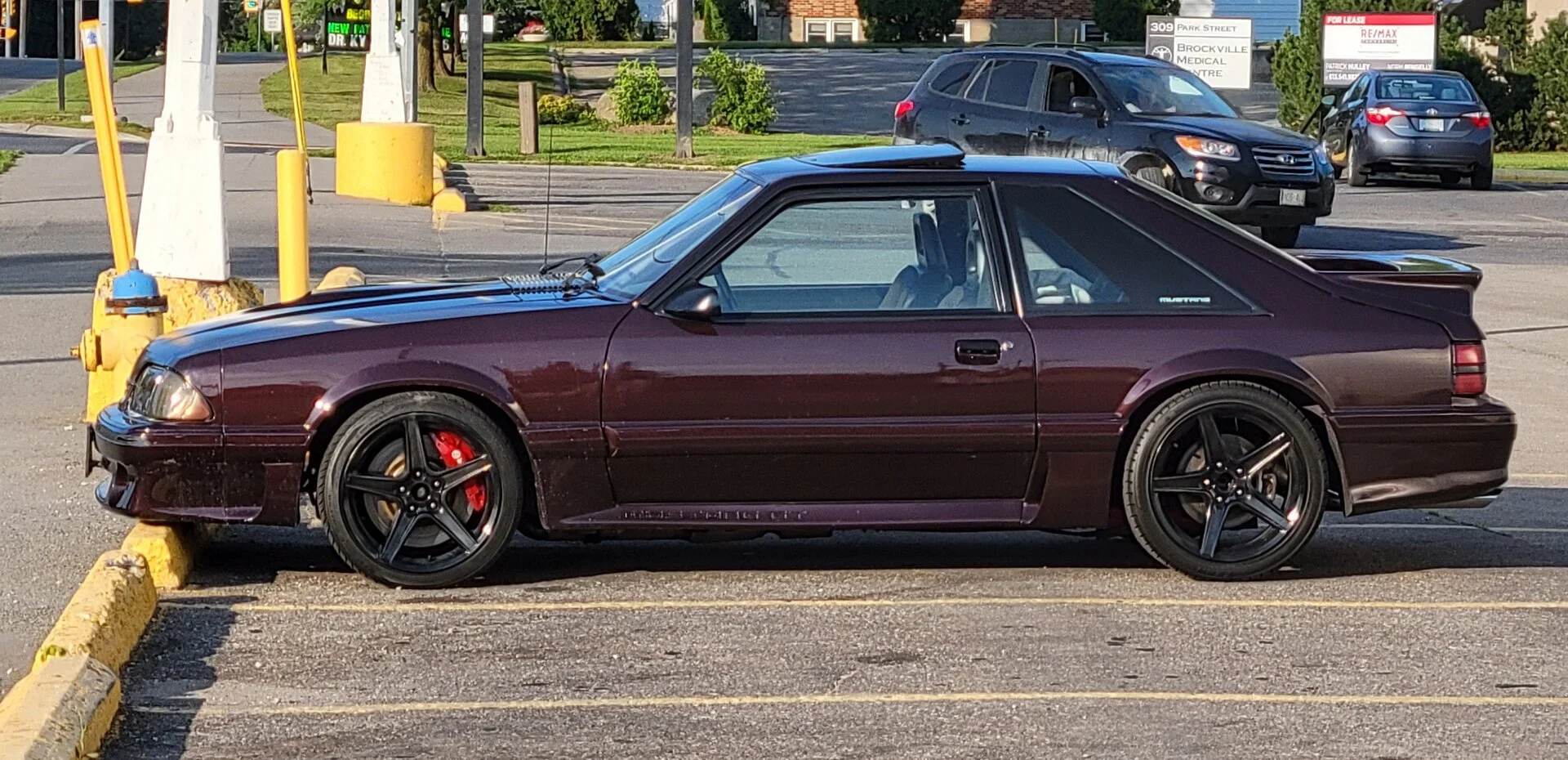

Which ones did you get? Some are 1"x2" tubing and some are 1.5"x2" tubing.
I built my own using the Mathis Performance Handbook 2 instructions with 1"x2" tube. I added seat supports with a simple piece of angle iron.
I don't know how much I lowered my car, but based on current tire gap to wheel well I would bet I am at least in the same range as you.
I find parts of my exhaust will hit a speed bump before my subframes will (usually right around the cats).
