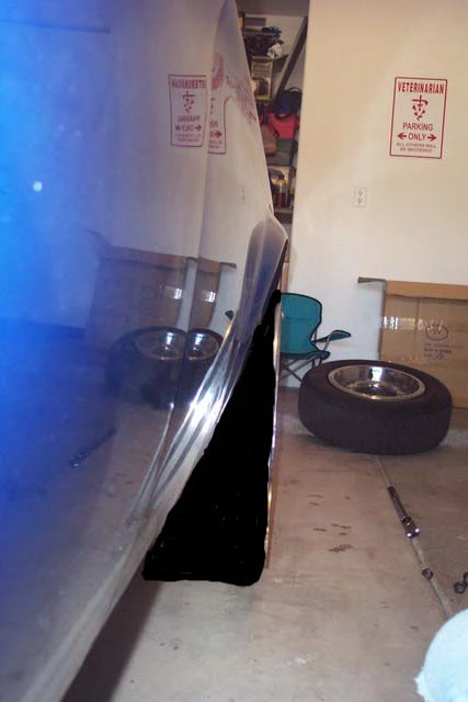

I've vacillated back and forth long enough on wheels for my '68 - I finally decided to make the plunge and buy one and test fit it. I wanted Bullitts, but didn't want to deal with the potential safety issues with spacers, so I bought a Verde Wheel Replicas Bullitt from www.customwheelsmarket.com, 17x8" w/ 4.50" backspacing, +0mm offset. This seems to be a widely used wheel size on 67s and 68s. Unfortunately, it doesn't seem to fit terribly well.
http://www.my68gt.com/gallery/bullitts
The rears seem like I need a good bit more backspace than 4.50", and also appears like I could use a wider wheel, especially if I BFH'd the bump stop flap.

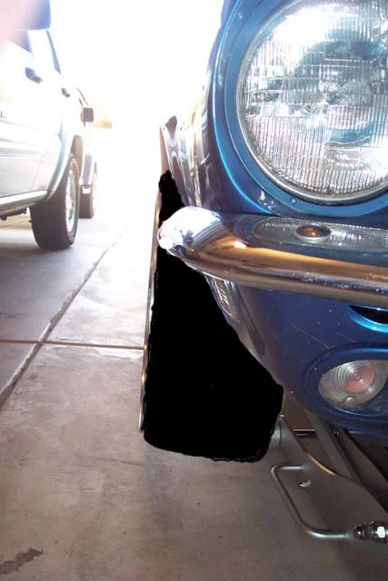

The fronts - I'd feel like a ricer with my wheels sticking out that much. However, it looks like I've only got about .5" clearance between the tip of the rim and the edge of the UCA - the only picture is at a bad angle and makes it look like the UCA is below the rim, it's not.
I'm probably going TCP - eventually - which seems like it would give more clearance on the UCA, but that's the future.

Third, about the upper arm to wheel spacing... 0.5" is adequate spacing between the upper arm and the wheel. Depending on where the closest point on the arm is, you may be able to grind a bit off the upper arm. I had a similar problem and only had 0.25" of distance between my upper arm and the 15" wheel I was using, so I ground off the outer lip at the end of the control arm (at the ball joint) to gain an additional 0.25". This worked fine and I never had any problems with interference.

ok i looked at your wheel fitment pictures and decided to try to draw where the tire would be on there.....it looks like it would look more correct when the tire is on so i dont know....i just did this in 2 sec so its not precise but its like an idea i suppose....
here is another shot....i dono if it makes a difference....but i think it changes the look a lot with a tire on it and makes it look pretty decent if not pretty good.

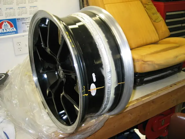

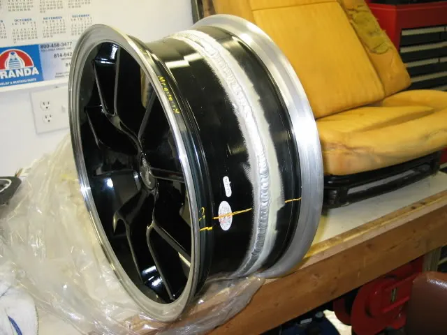

My 68 has 18x8 front wheels with 5.42" back spacing plus a 1/4" spacer for a total backspace of approx 5.16". They fit ok without the spacer except the wheel lip rubbed the UCA's (GW) near full lock. On the back I run 18x9 with 5.94" backspacing and no spacers.

The wheel backspacing you described is a 9" wheel that will not fit the front as 8" is all that will fit (maybe 7" for a 65/66). The wheel in the pic below was an 18x9 +36 that I had narrowed 1" by www.weldcraftwheels.com. This makes the backspacing 5.41" and with a 1/4" spacer the total is 5.16". Without the spacer the rim rubs the upper control arms at full lock.
