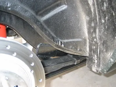

Thanks...in those pics the car still has 18x10's and 295/35's on the back. This rubbed so I went smaller instead of raising the car up.
May i ask where the were rubbing? I'm considering a set of 17 or 18x10s for the back on my 70 mach. Was the offset just right for the tire to line up with the edge of the quarter lip? I'm guessing it was rubbing the wheelhouse but thought i would ask. What offset were those 18x10s? I wonder if the 70 cars have more room out back than the 68. Seems they do everywhere else.
Did it rub only on very hard bumps or on light bumps? Anotherwords if it hit on hard bumps then a hammer would have worked cause there wasn't much more suspension travel left. If it was light bumps then you had alot more suspension travel to go and a BFH would be useless.
I would say that it rubbed on moderate bumps...enough so that I was sure the only fix was going to be raising it up which I did not want to do...IMO large wheels with lo profile tires look dorky without the right stance...plus who wants to slow down for every friggin ripple in the road
