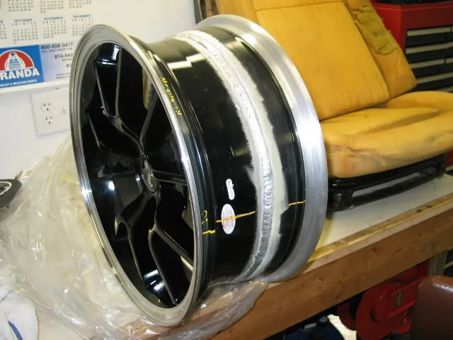

BIG-MAC said:
:shock: You are allowed to do that? That is soooooooo illegal over here!
Allowed? Some people think it is not safe and I imagine some racing organazations might frown upon it as well....but if it is done right by professionals like www.weldcraftwheels.com then at a minimum the modifed wheel is just as strong as the original. It is also somewhat common for people to widen wheels.
Yeah, 'banding' of wheels used to be common over here, but if done badly it is dangerous - how can you tell, as a buyer of a second hand wheel, or an annual inspector if it's been done right?
If you've got confidence in the guy that's done it, and you don't have annual inspections, go for it!
