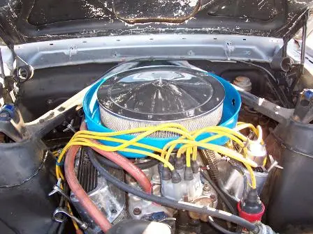

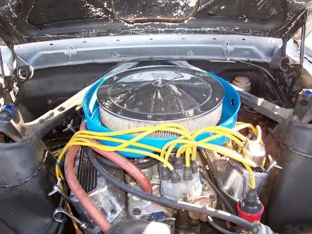

I'm using the original base with the snorkel blocked off and drain holes drilled with a 14" air cleaner. No problems what-so-ever. The original base clears the fuel inlet on the edelbrock carb without the need of one of those crappy plastic spacers.
