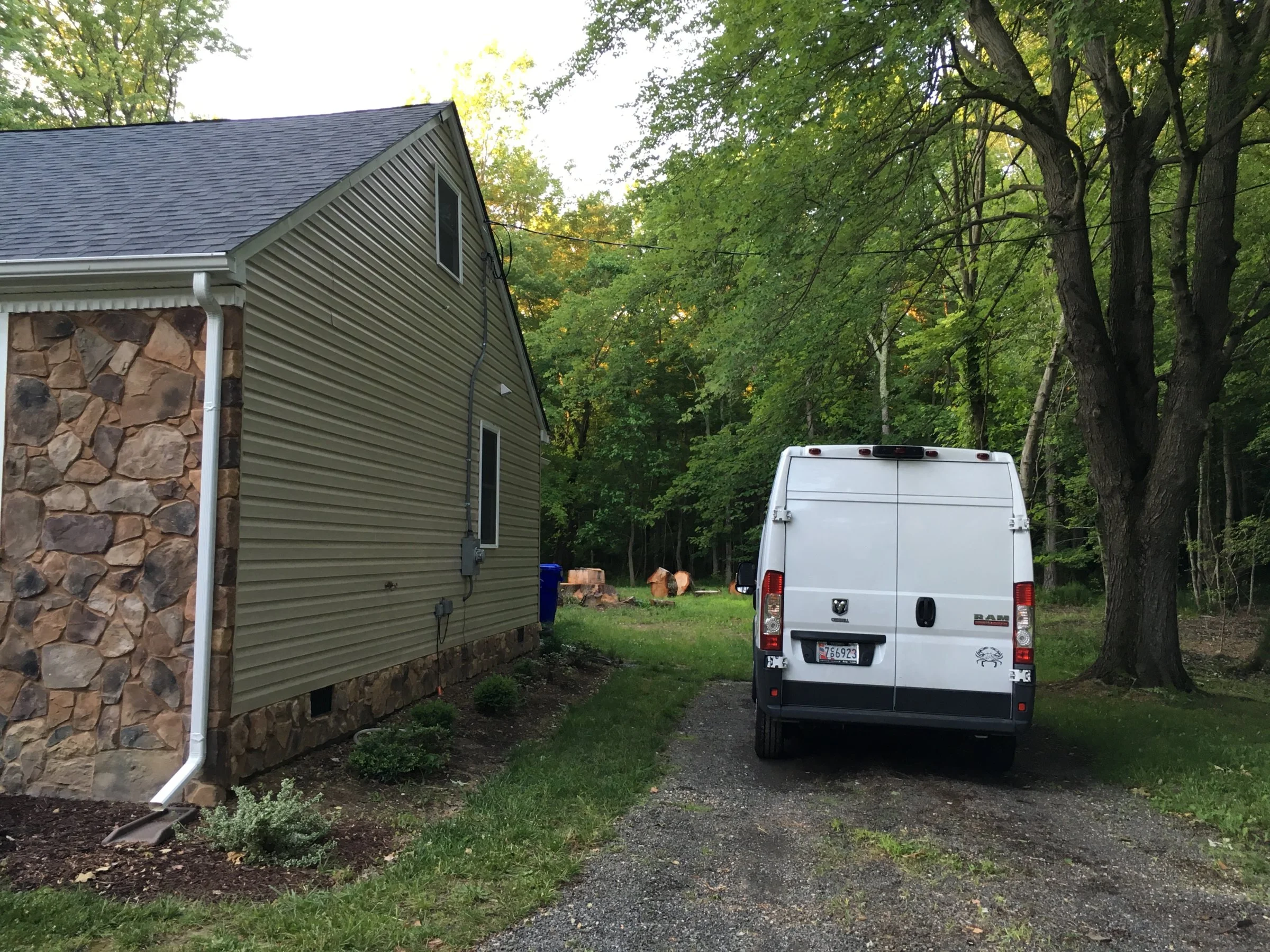

This is where my garage is going to be attached to the house from the ground to bottom of soffit is 9'6" and I'm only going as far back as my electric meter. I will however have the garage bump forward about 3 feet to make my 25' I'm looking for. The trusses will go in opposite directions the house trusses are sitting now.

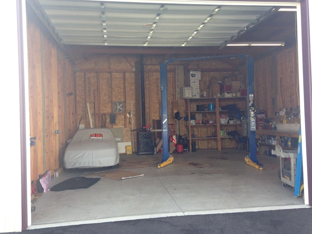

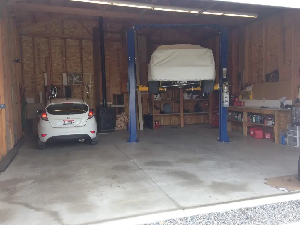

Does the lift bars slide inside the rail? My buddy has a lift but it has the hydraulic cylinders that go up with the bars so he can only bring the car up 3.5 feet before the cylinders hit his ceiling.. If this lift stays contained in itself like I need I can fit the lift between the trusses I would think I'm not gonna totally finish the garage off . I might have just confused everybody though with this

yes inside the vertical beams, it lifts to a height of 72"
here is the Fox on the lift. for reference
