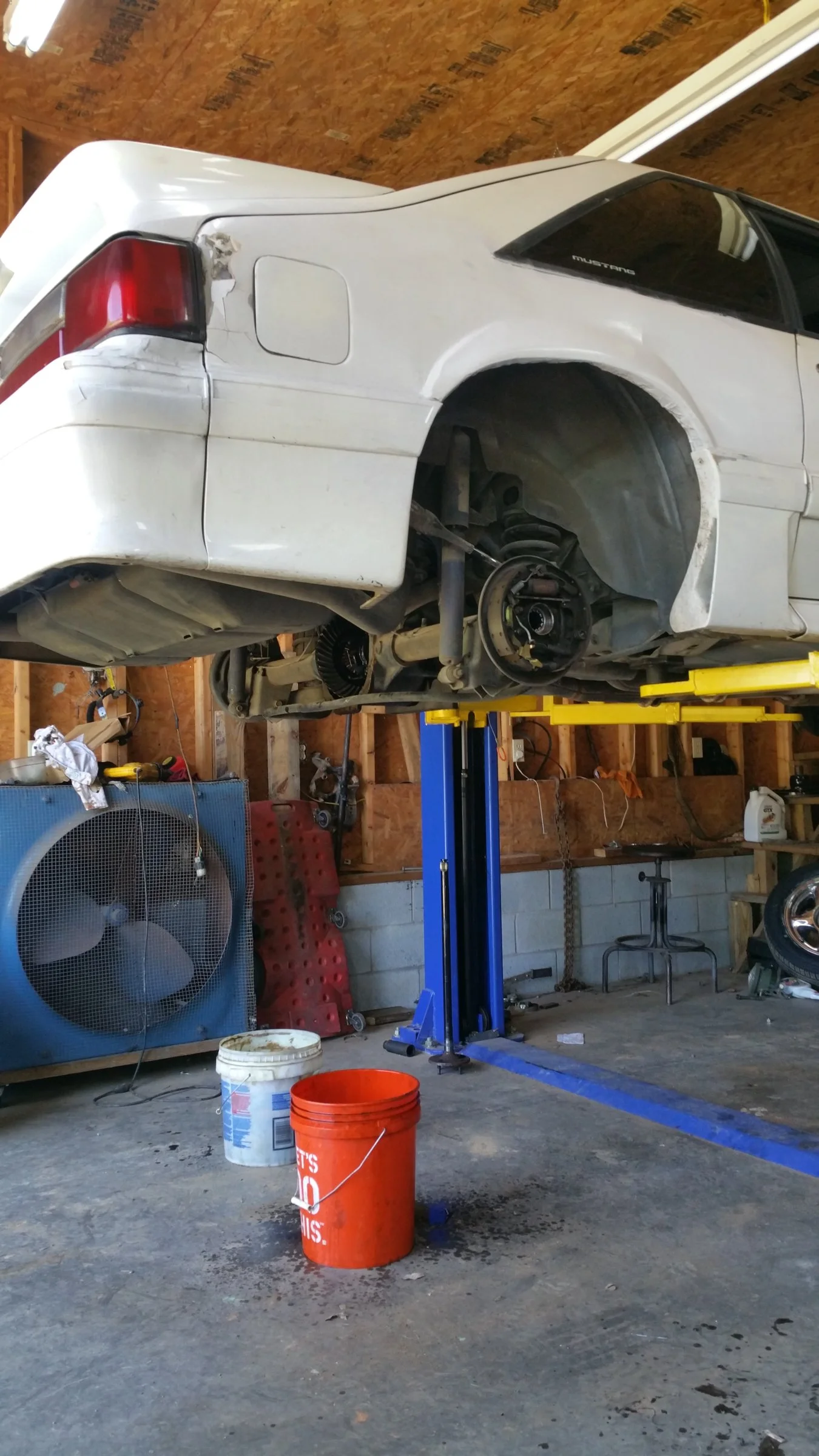

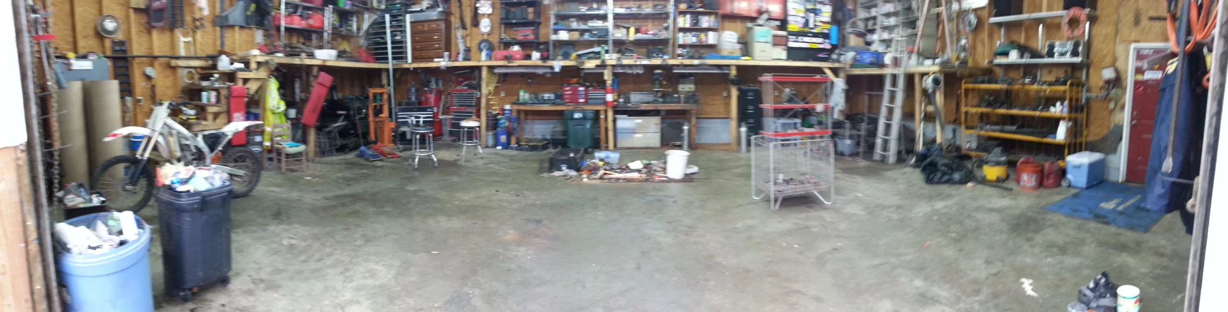

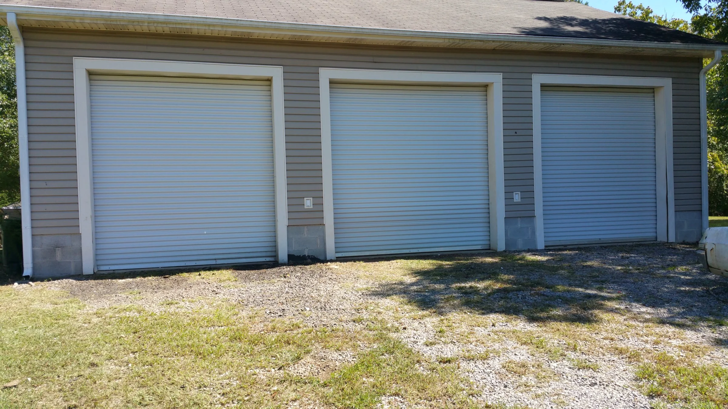

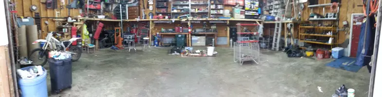

Heres my shop. Its a 30x40, with 13' interior ceiling. The doors are on the 40' side, with the layout like this: 9' door / 10' door / 9' door. The center door is wider so that I can back a trailer into the shop very easily. My lift will pick my car up high enough to hit the lights, and theres enough room for me (at 6' tall) to stand under the car and work. The lift is in the far left bay looking at the pic. IIRC, it was around $2600ish installed. Worth every penny lol. The panoramic picture is the inside of my shop before I installed the lift. I had to lose the catwalk section on the left wall to make room for the lift. The shop also has its own power pole, transformer, and panel... I get 2 power bills, but I never have to worry about what I plug in. And X100 on lots of outlets!!!

I'd consider 11ft the minimum for a lift, 12 to be good and 13+ to be optimal.
I have about 11.5 and a 4 post it takes about 11ft of that to get the car high enough to walk under (6'1).
But that's only half the issue, most likely you own other cars that won't be a mustang which is relatively low compared to an suv.
Just keep in mind, mine is in an attached garage that I go in every day, walking around a lift with a car on it gets old real quick.
It's also a 4 post, so you lose 5 inches for the ramps.
The good part about a 4 is you can safely park under it or on it anytime quickly and easily (which I do, but I don't let my wife).
The down side is to get the wheels off you need a $1000 slide jack, per end.
