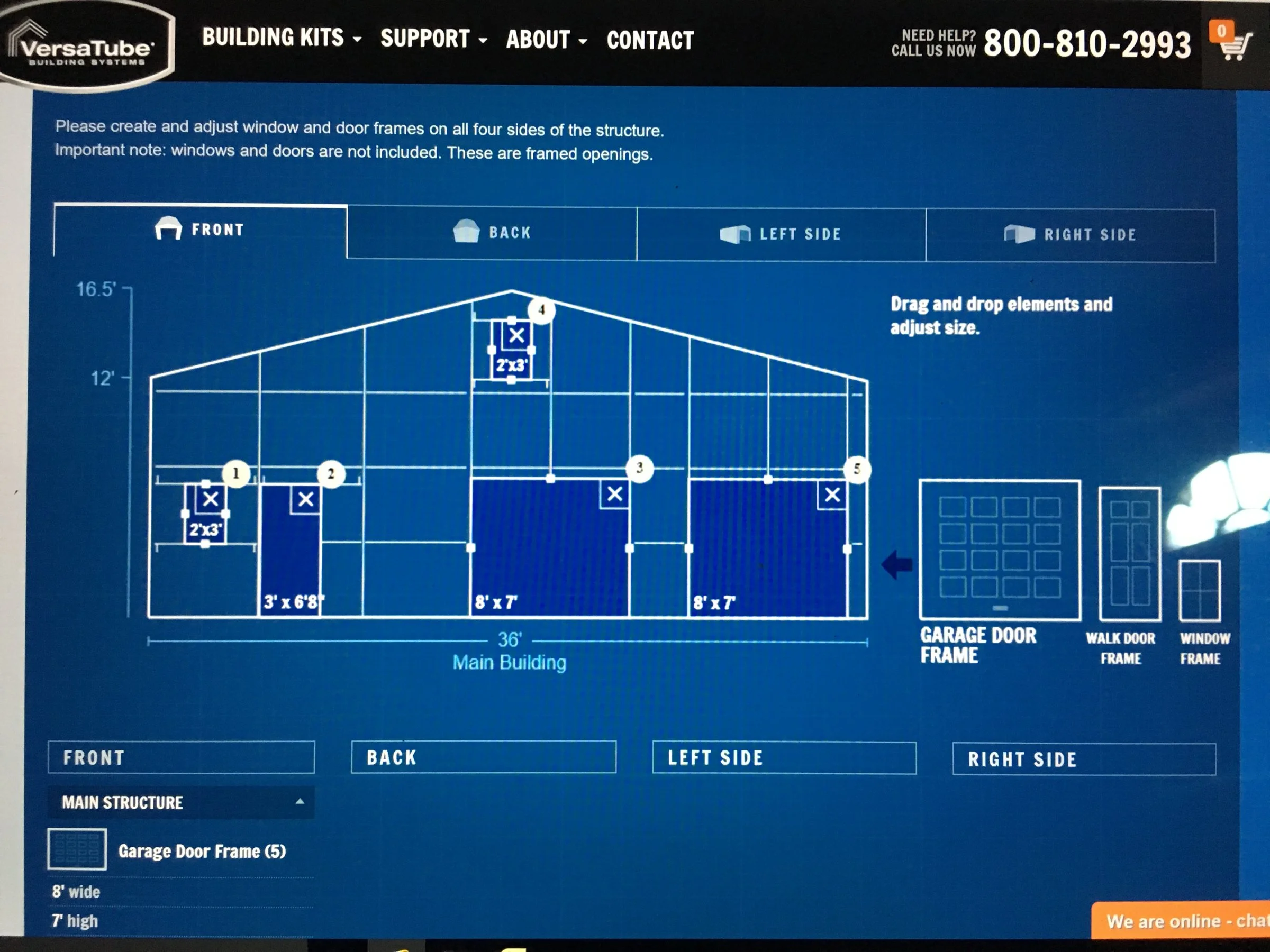

So I went to versatubes website sorry I kept calling it versamax lol I designed this it's a 36x40x12 they only offer 8' wide doors I'm gonna try to email them and ask if they have larger ones available. You can get the idea of how I want to lay mine out @John Dirks Jr i do have a 200 amp panel and two spares both double pole one is 20 and one is 30 could I swap one of those out for a 60 or 70?

You can swap the smaller breakers for larger ones, sure. Talk to an electrician about the load you'll need for the garage based on how you plan to use it. They can set you up for what you need. Welding can take some juice so if thats on the horizon, be sure to let the electrician know.

I agree that 8x7 doors are dinky. My doors are 9x9. 9 is narrow enough for my comfort.

Yes the salesman emailed me back and swapped them out for 9' openings now

Looks like those VersaTube frames bolt down to the slab. I recommend more than just a floating slab because frost heave can mess that up and if the frame is bolted to it, things can get messed up over time. So, some support for the slab would be nice. Either a turn down footer monolithic slab or a block perimeter wall. Either set at the frost line or below which I believe is 30" deep in your area. My wood framed pole barn garage has the posts bearing on footers that are 36" under the grade.
Point being, a floating slab on the surface can move with frost heave or settle too. If the slab moves, the building will too and things can buckle.
If you factor in proper support for the slab, you'll see how the cost of wood frame pole barns become more inviting.

Yeah I had every intention of pouring a monolithic slab

Good deal!! Get rebar in the footer to turn up into the slab edges. Lay some ground rods for electrical in the pour while your at it. And a conduit for the service feed. Maybe a second conduit for an ethernet cable from the router.
One of the biggest challenges with monolithic pour is getting lots of material on site in a relatively short period. But you have a family member in the business you I'm sure you all all the bases covered. Good luck with everything!
