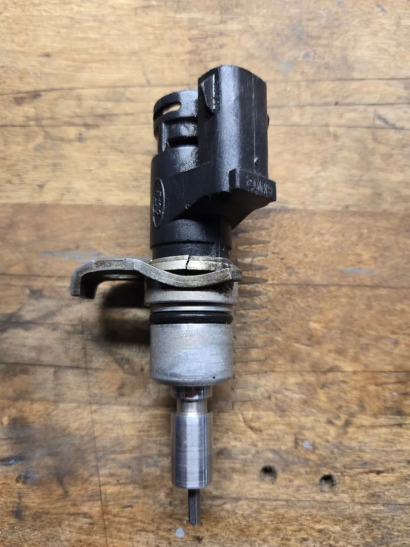

You'll know when you jack it up. I had the same thing last week. Mine ended up being the speed sensor was cracked.
It was dripping trans fluid on the drivers side X pipe. Some was dripping to the floor, some on the crossmember and then to the passenger side x pipe. It sure was making a mess that little sensor.
