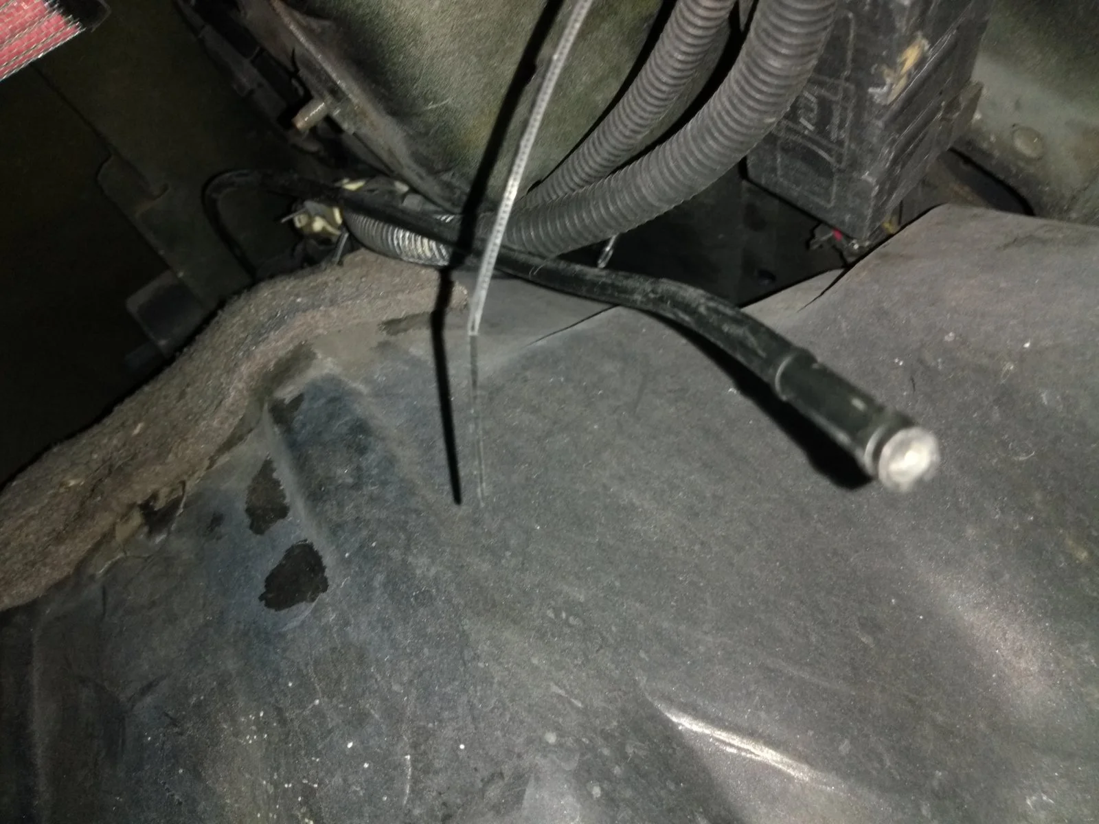

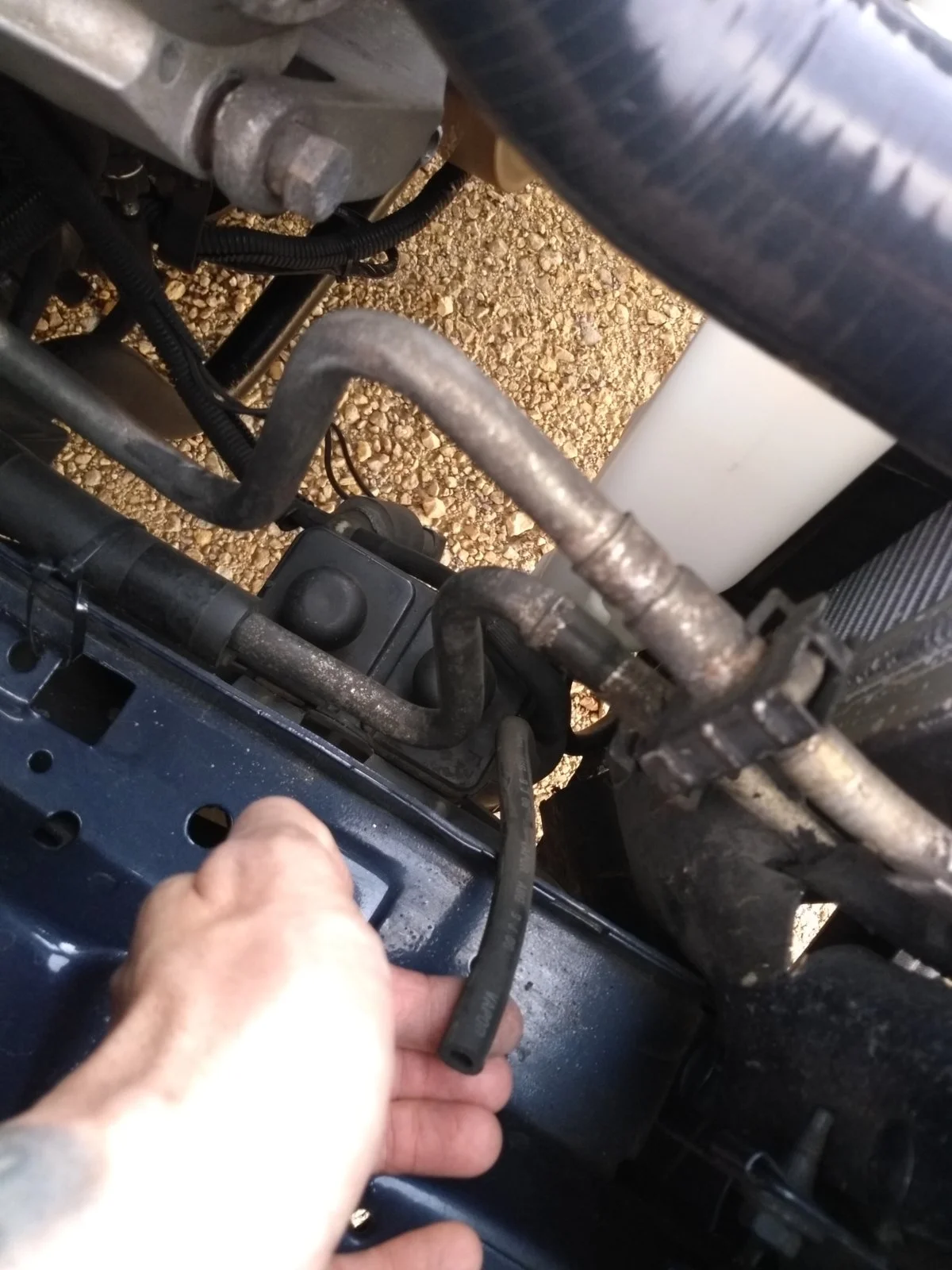

I replaced the fuel filter last year. I don't see any fuel puddles anywhere. I just looked at the charcoal canister. Last year I pulled the line off at the intake and it had a cap on it. So I took the cap off and then put the hose back on.
But now I see the other line isn't hooked up to anything. I'm wondering if it was deleted. The EGR is also off the car.

You are probably missing the vent tube line from the gas tank, you kinda need that.
There seems to be some hard plastic lines in the inner fender area that are not hooked up.
Many years ago I think I removed that whole evap on my old car. I'm starting to think it's not hooked up at all. Wondering what I should do.
Maybe, cap that hose off again going to the intake.
I'll have to check everything out. I'd assume it still goes back to the tank. Don't think I can get to it without lowering tank.
There is a hard to line under the car. Toward front of pass floor pan, the plastic line connects to the steel line and runs to the canister.
In the back, the steel line stops and then there is a about a 12-18” rubber hose that connects to vapor valve. You may be able to reach up and connect without dropping tank.

I think I found the line in the fender. Installing it on some new hose.

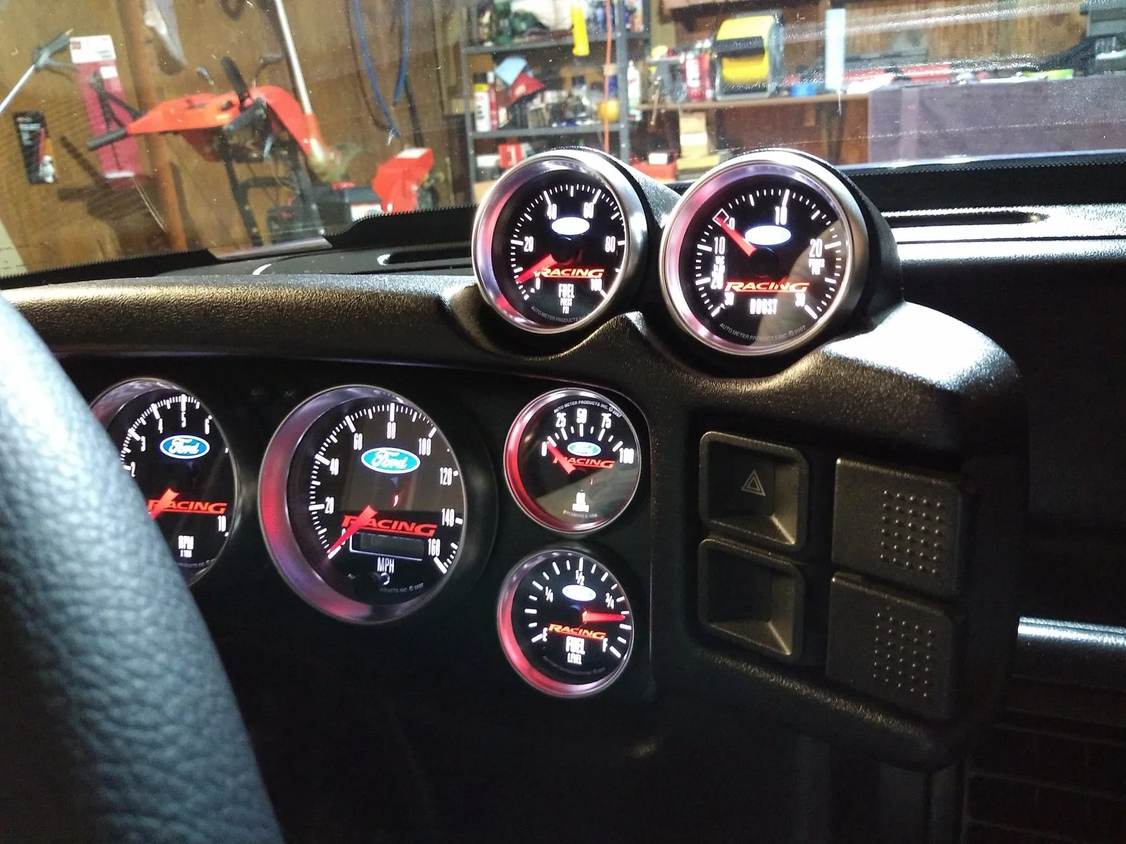

Got a lot of work done today. I have the charcoal canister all hooked up, swapped out injector harness, and installed two more gauges.
Now I can monitor vacuum and fuel pressure while driving.
Its been raining today, so can't drive it until Friday. Car seems to run good at idle.
Thanks for the help everyone!
