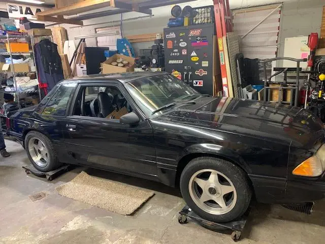

Hello everyone, new to the forum! I just picked up a 1987 Notchback and am working on getting it roadworthy. This was a local 2 owner car. Spent the last 15 years sitting in a garage. I am doing a preservation and will be driving/racing the car. Mechanical items will be my priority to get it running. Picture attached for starters!!
First on my list was the fuel system. Figured it would be easier just to replace all since the gas has been sitting for so long. Items listed below. Am I missing anything? Preference on a place to purchase? Any info appreciated!

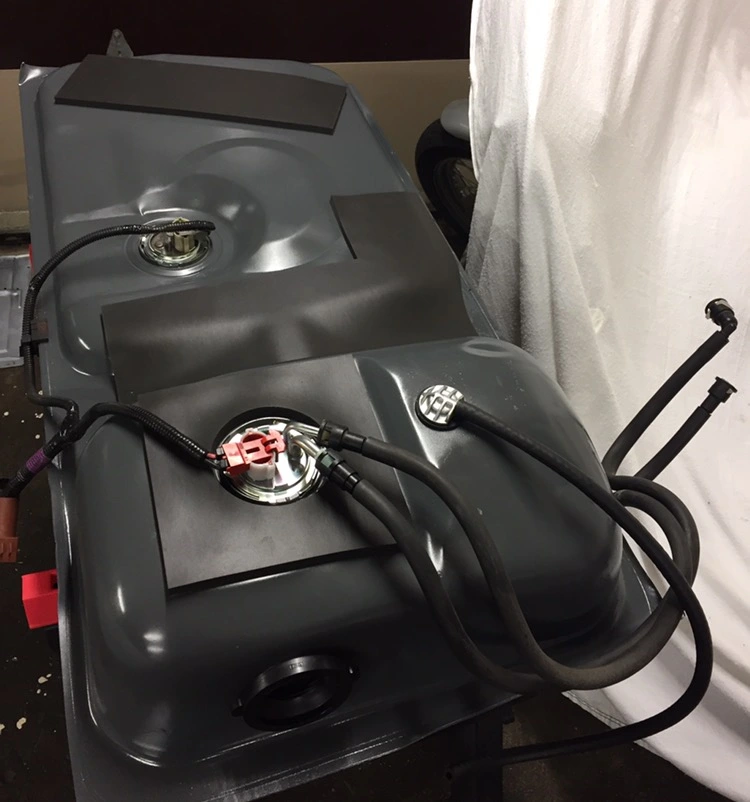

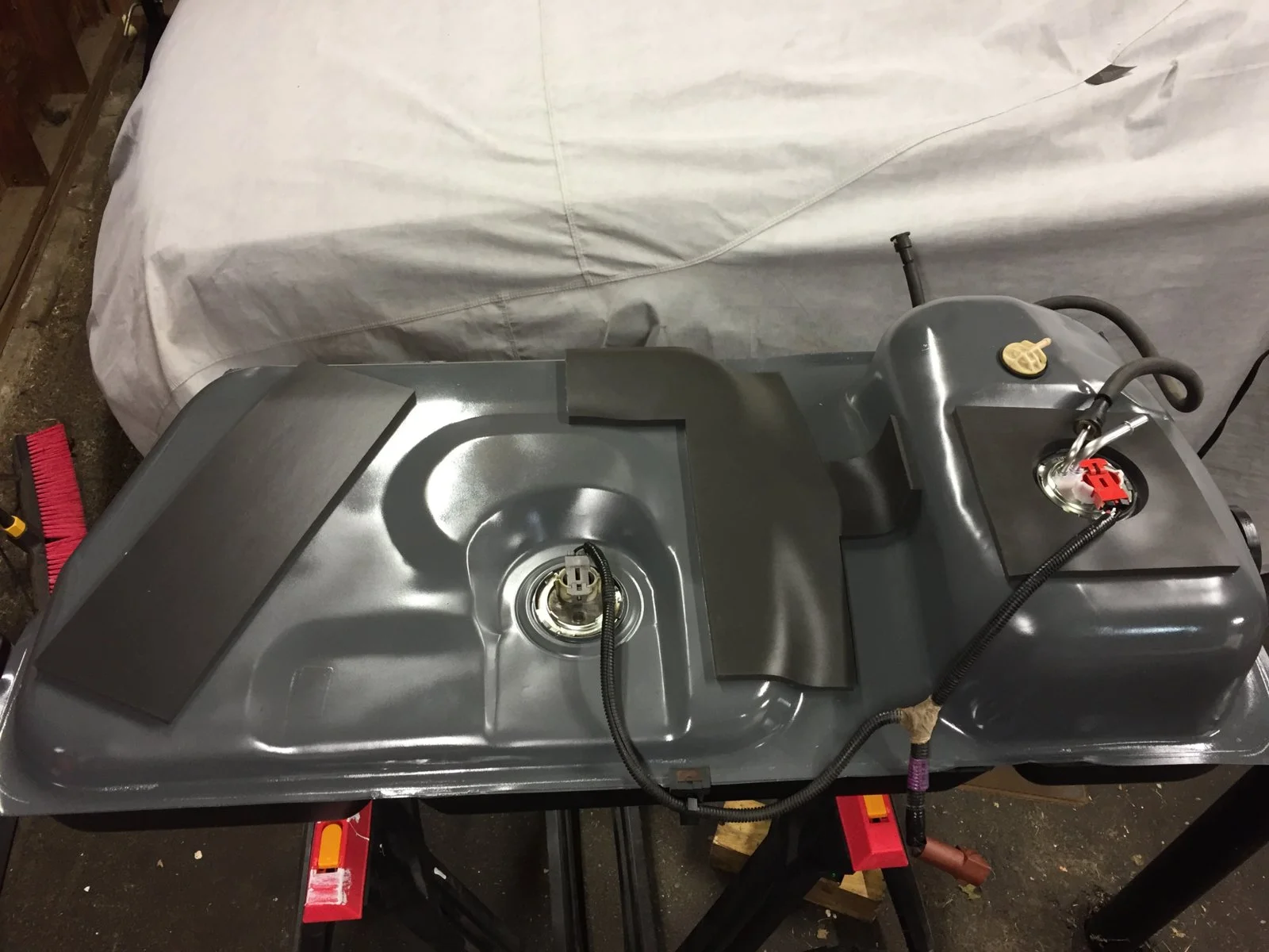

I did this myself last winter. Everything new except the fuel level sender

By far the best looking gas tank I've ever seen! Dang

Really nice. Does the tank come from RockAuto like this or did you have to paint it yourself?
