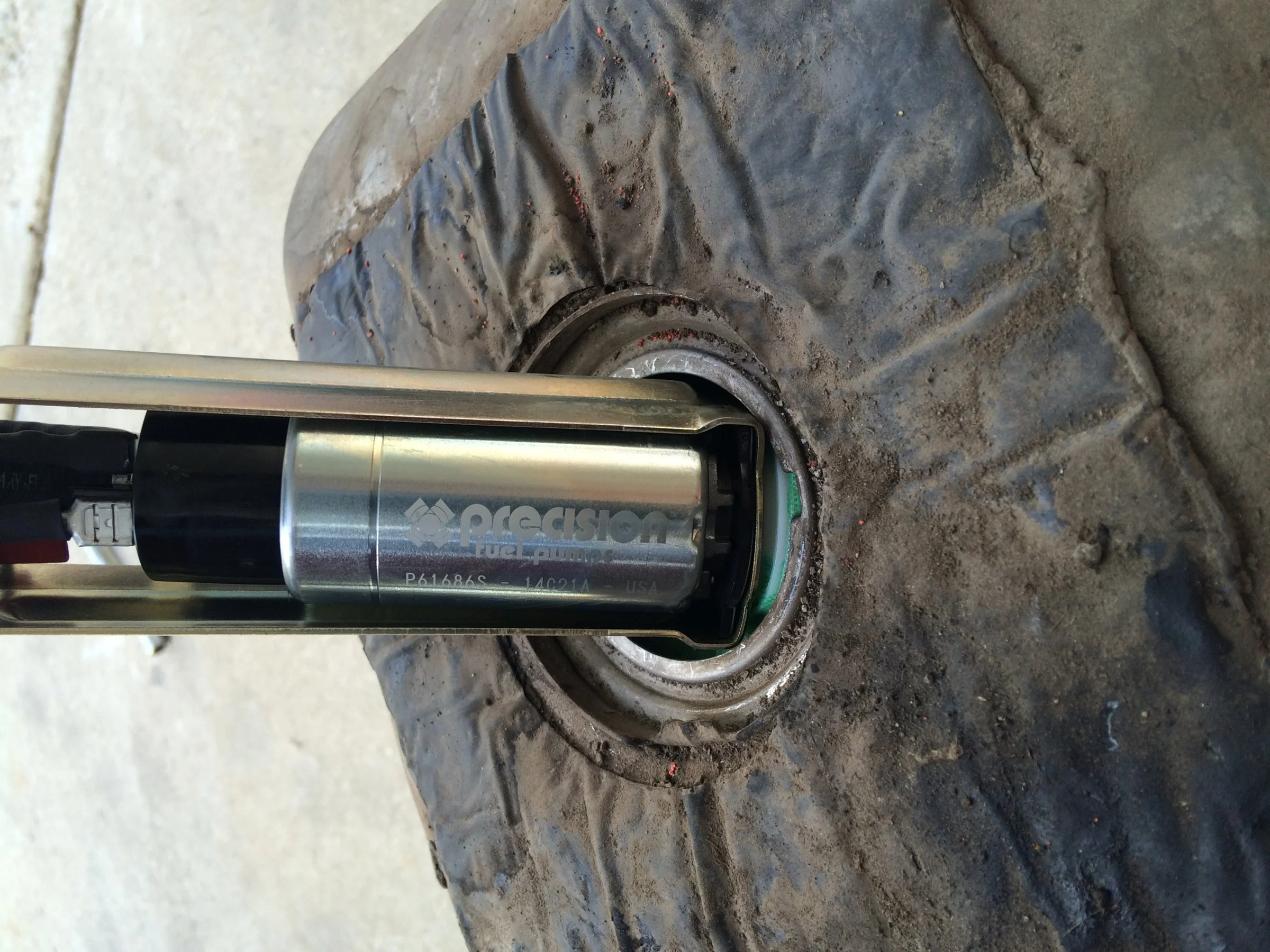

I'm curious what volume fuel pump you're running.
I'm guessing just the stock volume, I pulled the tank just over a year ago to replace the leaking filler neck seal along with all the rest of the seals just to be safe and at that time I snapped a pic of the fuel pump which is a Autozone or O'Reilly replacement pump
